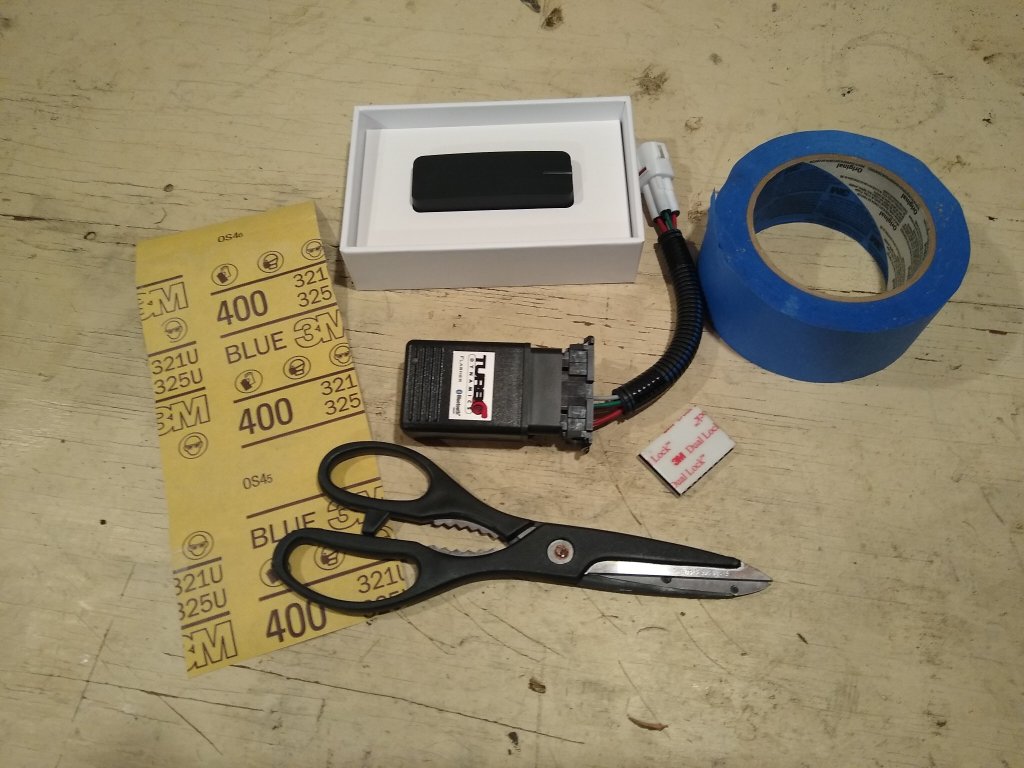

This is what I used been on my sled for over 4 yrs and I use this at work for surfaces that double sided tape has issues sticking to works awesome.Who knows?!?! I use that "I lock" grade. Seemingly uses a pretty stringent adhesive.
But I'll do as you, clean it, heat it and stick it....see how it goes.
I'm pretty sure I've seen other posts here in the past where guys are sticking it right to that cover, but never followed up to see how it's going.
I get what you are saying now...yes that would definitely work as well.Look again .....the flasher is OBD2 the extension cable goes in between the flasher and the GAP conversion cable to CAT diagnostic connector

In following with no1b4me's instructions, I suppose I'll mount my flasher to reverse actuator cover. Wish me luck.Mounting on actuator cover ,hit it with 400 grit ,wipe clean with alcohol and apply velcro...works everytime ....aluminum cover is too smooth to get a good adhesion bite ...

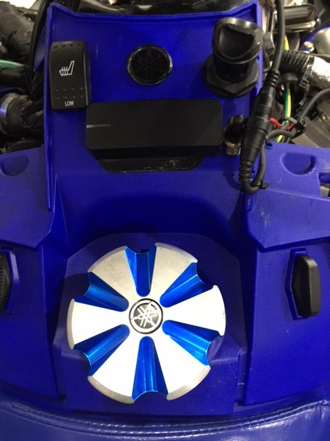

I'll just mount it on the console and use my cover overnight.
I just mount mine on the council and put it in my handlebar bag when not in use....a lot of people just carry them in their pocket.I'll just mount it on the console and use my cover overnight.

I didn't think it would adhere to that porous plastic. Thank youI just mount mine on the council and put it in my handlebar bag when not in use....a lot of people just carry them in their pocket.
