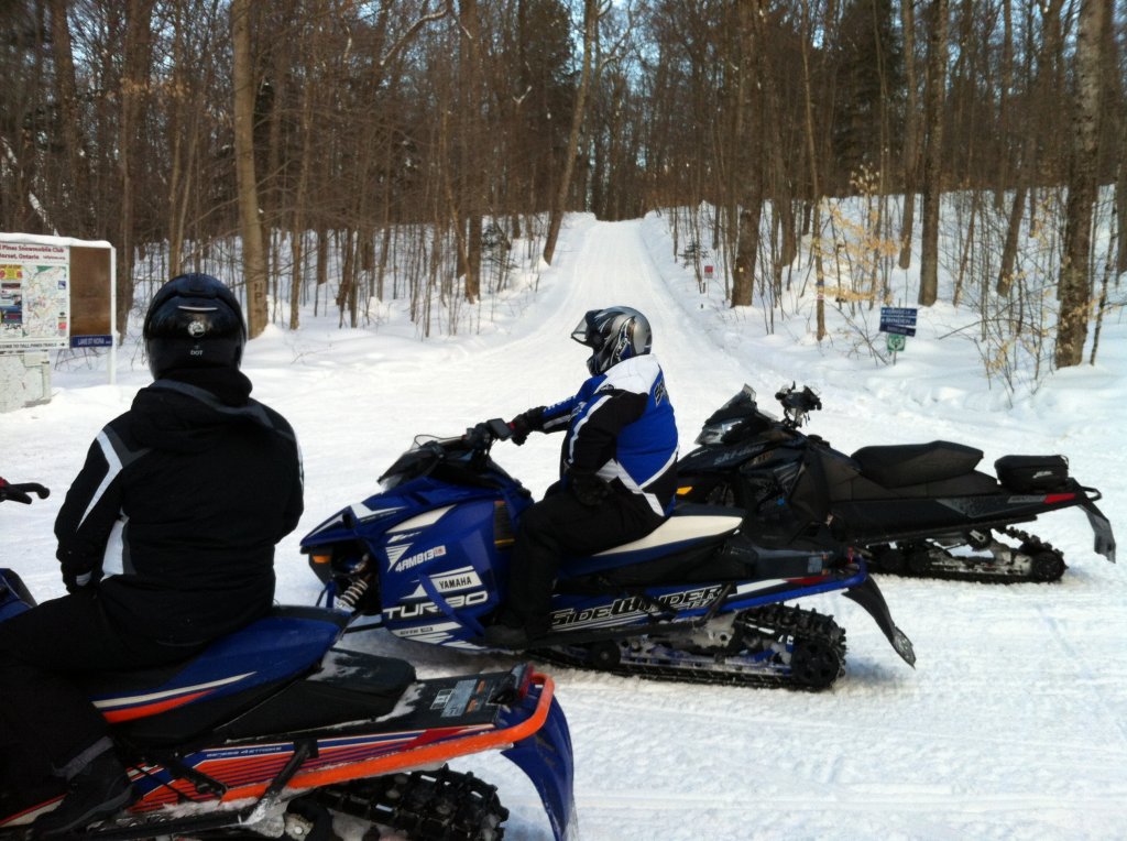

The rear suspension and how high the rear of sled sits was a HUGE issue since 2014 for me, when I went over to DOOs. My '14 800 etec and then the 16 1200 4tec, both were XS chassis. The 800 etec would heat up super fast when hitting a road or glare ice, and the 1200 4tec was alittle better being a 129'' with more rear cooler/drop down. But both of the Doos would not take long when we would get to a lake with little snow, and we have alot of lakes around us.
Last season riding with the new 850(buds) I went HOT about half way across Lake Muskoka(large lake) while his 850 was still just in middle of the range, and safe. The ACE 900 running with us was also safe range, and the POOs with us were always fine with no heat issues. So the new tunnel design of the 850, doo has done a nice job with the new cooling within tunnel design, nice work there.
On the XS Doos, the Rmotion needs to be run low. DOO has a large amount of SAG built into their Rmo skid, which is why it rides so plush. The DOO flap design is like no other too. So their flap design and low sag keeps snow under the tunnel and snowdust curling upward into the tunnel. The flap has a curved/bent inward at bottom design when looking at it from the side, it follows the track as it curves inward around the rear axle wheels. I often watch buddies sleds as we ride side by side on lake, to see how snow dust reacts. Each sled design has different ways of throwing snow around. The Doo flap is best at keeping it in tunnel.
Sit on a Rmo DOO, and measure how low that curved flap rides to ground after sagging with your weight on it. Now do the same on a Sidewinder. The difference is huge. The SW just does not sag much, and also the SW/Yam snowflap is more straight and even bent outward as miles pile on. Me being around 185-190 lbs, Mine will sag even less, even though I run torsions on 1.
So I believe a DOO flap, trimmed to add the bottom few inches to stock SW flap....this would add the curved inward section. The trick will be to make it long enough to aid on cooling, yet not too long to have reverse issues with it catching on studs.

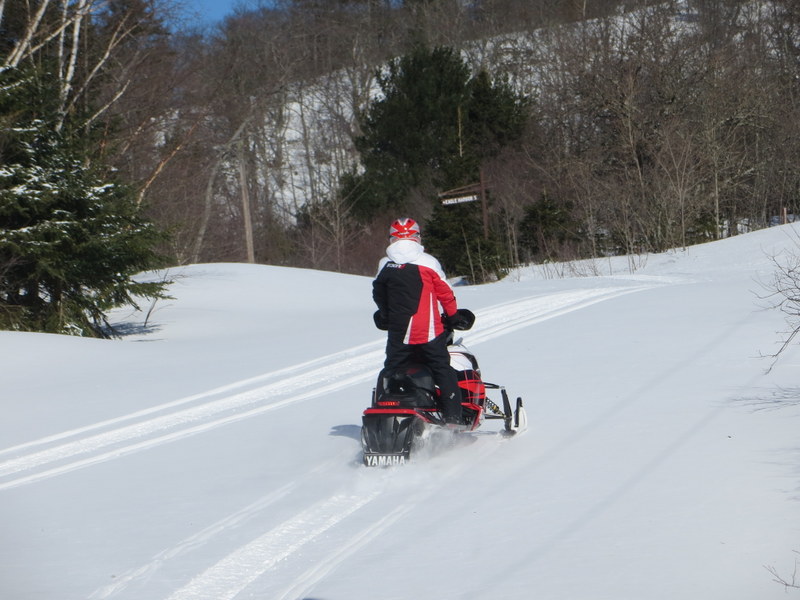

Below is a good example pic.....Toms SW(LE 137) with him SITTING ON IT(he is a big boy!) and look at his flap to ground distance....while my DOO XS 1200 sitting next to it, with NO ONE sitting on it flap distance. And when I sit on the doo it drops right down near 2.5-3" lower.

Awesome post Dan. You pretty much have nailed all of the ride height issues with the SW LTX and I think that you ideas regarding a flap mod is spot on. Your pics are a great example.
In my previous post on this thread I mentioned that I swapped out the skid torsion springs on my SW LTX with some lighter rate torsion springs that HyGear sells. I'm pretty sure that these are AC lighter rate springs but they actually re-arch the spring ends to achieve a lower ride height in addition to a much improved weight transfer and lighter steering effort especially with aggressive skis.
I'm not a real big guy...about 145lbs. and had the springs set at full soft.
Here's a couple of pics to show how these springs have brought my flap down enough to collect a lot of snow.
