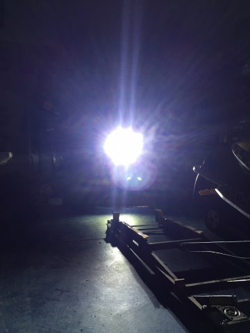

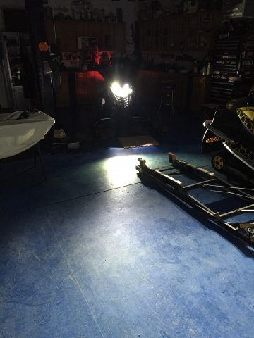

I just installed some Cree LEDs in my viper,very nice units ,simple plug an play install,don't know how they compare to HIDs,but they are bright as hell,very even pattern with no hot spots,I am impressed.

Got them off amazon. Tried them tonite and they were awesome ,plug and play,no ballasts to mount no extra wires,my only suggestion when looking for LEDs is to get the type that have led on both sides of the stem,I have these and they work great!Where did you get the cree LEDs from? And what kind exactly highly interested in led

Before
After
After

does the led light actually produce more light and put it on the ground really well or is it same as stock but slightly different color ? Because it's hard to tell in picture but the stock looks like more light on the ground
SISCAKIDD
If you look at the pictures you will see I did a bad job of taking the pics from the same spot,I was much closer in the after picture not allowing you to see how the light floods the area,I lined it up with a 2014 skidoo and the light was deffinatly brighter than the doo,I don't know how they would compare to a HID set up,buts it's an improvement over stock.
