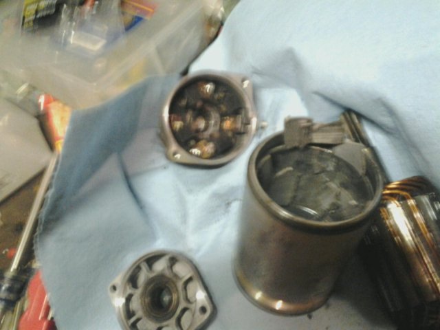

Magnets broke in starter.....but it is a nytro
That's old news and easily corrected with a new starter and sometimes solenoid. Had a case last year where someone hooked heated shield to power at key. Back fed and starter was running all the time. Same thing. Magnets no other damage. Don't get why you post this. It's not the issue most are worried about. Parts in engine. Don't make light of the real issue. Don't really care about a trashed Nytro starter.
Point is this starter has had issues in the past and even now in other than Viper applications. This starter was removed by my brother in his Nytro yesterday. Some make a point about this being a Viper only issue and not all of it is.
