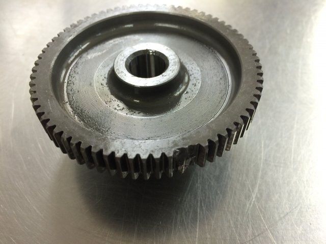

Starter dead.....View attachment 115238 View attachment 115236 I had to remove the magneto cover because another turbo bracket related problem and look what i found! The starter was still good!
There are probably so many sled that are running now whit litle metal piece in the motor..... I have the towel in my hand even if its the best riding sled i ever own! Its a part time job to Own and ride this sled! Lol
250km from civilisation!
I had to " pull start " whit 30 ft belt on the bumper of my buddy sled,that work at the first pull. thanks god i as not alone....
Now they gona charge me another oil change ,here in canada oil is not covered....... Loool. I now understand the YAMAHAHAHAHAHA thing...... They DONT
What a shame!
I am waiting some answer from Gene from W/K for the evo flash ! I REALY hope it will solve some problem

I just joined the forum. I have a 2015 XF7000 LXR Cat that I got through the winter with no issues. 1400 km. I am quite concerned about the starter failure so much that I installed heaters to warm the engine for my trip to Cochrane. With this, cold starts were very quick and easy. I also hold the key until it starts and wait for the fuel pump first. I don't think I ever experienced the kick back stopping the engine while cranking.
Anyway, after reading all these pages, I would like to change out the idler gear this summer as a precaution. However, not sure what to use for a gear. Has anyone noticed the 2016 engine has a new gear number. Will that work? Or is the updated 2014-2015 part number a good gear.
The failing gear in question could possibly be a "Powdered Metal" gear with very brittle teeth. This process is where a powder is loaded into a mold and heated under pressure. Many things are made this way including Cat clutch cam arms. The color is a dull grey.
There have been Cat failures as well on a few forums, but nothing like on here. I suppose, there were many more Vipers built than Cats since Cat pushes 2-stroke 600's and 800's.

The gear in the 16.5 motor won't fit the older motors. The gear in our older motors is a different part # . Is it better? We don't know because Yamaha has not said a word. I was holding that updated part# gear in my hand just the other day. Sled half apart. Would only take half hr to replace the gear if that. I passed out of fear it could be worse than the one in motor already with 8000mi on it. Yamaha needs to explain why different part #. Release a Technical Bulletin. Talk to the dealers. Really is embarrassing the lack of communication.

It would seem that MRUPNORTH got a new update gear in his sled the last time his repair was done. That looks like it was back in Jan 2016 or earlier so the new gear has been around for a while and I bet many sleds have it in there from a repair but don't know it. So if the gear is in fact better, then the problems will eventually go away after a repair is done. This may be on purpose to eliminate a recall and keep the problem quiet. Although it's not too quiet here. I don't think many Cat guys know anything about it unless they had a repair, and all of them just think it was a starter failure. That may be the master plan of the companies involved.
