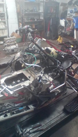

Well I just got my wife's sled back from the dealer after starter replacement! They said it was the worse they have ever seen as you can probably tell by the tear down picture above.
The starter went the end of March on our second from last ride. When I told her that it made a horrific noise during startup she stated let me see and she proceeded to start the sled and the starter made less noise that normal. So of course now she is accusing me not wanting to go riding. LOL. So off we went and rode 250 miles over the next 2 days. The starter was working when I took it into the dealer a few weeks ago. The mechanic was amazed it was working, three broken teeth, the magnets were broken in multiple places, etc. the new starter sounds better than either of our vipers did even when new.
They told me to bring the other sled in this fall so they can check that one too!
It sure is nice having a great dealer!

With my dealer I have never had to feel the ouch! Oil and filter change were included in the repair so one less thing for me to do. Making it through the season was lucky for us and the dealer. I was able to bring it in during a lul in his workload and he knew seasonal work taking precedence was not an issue with me!
Thats awesome! The ouch is for me. Everytime I see one of these especially from well known members I feel like someone punched me in the gut. Just waiting for my turn.

I had heard so many people talking about their starters failing after one incident that I was expecting to have to tow her sled every time we stopped and shut off our engines. The sled must have had 15-20 starts after the Big Bang event.Thats awesome! The ouch is for me. Everytime I see one of these especially from well known members I feel like someone punched me in the gut. Just waiting for my turn.
Was it a "Kickback" that started it?I had heard so many people talking about their starters failing after one incident that I was expecting to have to tow her sled every time we stopped and shut off our engines. The sled must have had 15-20 starts after the Big Bang event.

Yes, first start of the day, first turn of the key, a loud bang that either caused the engine rotation to stop or perhaps the bang caused me to release the key. Not sure which one. The second start the starter made a lot of noise but the engine fired. All 15-20 starts after the second start the starter sounded quieter than before the Big Bang.Was it a "Kickback" that started it?
The sleds are kept in a heated garage normally about 42-46 degrees but occasionally 52 degrees if I'm working on something.
Its a great time of year to deal with a starter issue. I am glad we share the same dealer! He said mine was the worst he ever seen but it looking at your motor being out I think you now have first place for starter destruction.
However, you pull started your machine in the middle of the wilderness using innovative techniques to get home without being towed. In my book, you win! But yes my timing was better than yours, we did not lose any riding time due to the starter!
I believe my starter was number four replaced at their dealership.
