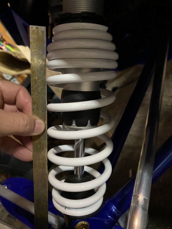

The only way to get a lowered ride height while maintaining full shock working length (travel) is with a progressive spring setup. If you were to simply use a linear spring you would have to use one that is shorter (to get lowered height) and stiffer (to maintain sit-in or sag). This would give you a very harsh ride.
The SRX front spring is not a linear spring, it has several features which make it dual or multi-rate.
1. Coils are not all the same size diameter (diameter of coil, not wire which is the same), see picture below
2. Springs have to cover a working range, this includes both the sit in height and the extended (unloaded) height/length. As you extend the shock you expose more of the tender spring (tighter wrap, and smaller diameter). This gives you smooth operation over chatter bumps while keeping full shock travel.
3. Coil to Coil gap changes over the length of the spring. Any time you change the angle of the coil you change its rate. The only way to make the coil spacing (gap) uneven is to change the pitch of the coil (moving the coils closer together or further apart).
All of this works together very, very well.
In the below picture you can see that the coils are different diameters. Its a bit misleading as the two above my thumb and the one below my thumb are the same size and the rest get smaller. If you want to follow along and counting up from the bottom (judging by eye) the first three coils from the bottom are noticeably smaller, the fourth is slightly smaller, 5,6,7 are noticeably equal, and 8 and above get smaller again. The coil to coil spacing also changes near the other end of the spring (bottom) with the last few coils are closer together. When the shock opens up, the gap in the upper spring grows (all coils separate) making initial impact soft and then getting much stiffer. Those tighter coils are stiffer, the way to think about them is to straighten them out and think of them as a lever, there is less material in a tighter coil so harder to bend.

The tighter coils are the softer rate. The coils that are spread apart further are the firmer, final rate.The only way to get a lowered ride height while maintaining full shock working length (travel) is with a progressive spring setup. If you were to simply use a linear spring you would have to use one that is shorter (to get lowered height) and stiffer (to maintain sit-in or sag). This would give you a very harsh ride.

Don't think of the top 4 coils as a compromise just so they don't hit the reservoir, they aren't, or rather they are but probably because the rest of the coils are bigger (diameter) than a normal linear spring. I haven't looked at a normal sidewinder linear spring to compare them but my guess is that the linear spring coils all miss the reservoir and they are uniform in diameter.
A dual rate spring typically is designed like they are on the SRX for a few reasons.
1. Keep pressure on the retainers in the shocks. This allows the shock to reach full extension as the suspension extends. (the sled unweights as you go over a bump or jump).
2. Once the spring starts to compress it acts like a dual rate spring where the spring rate is a combination of the rate for the looser coils and the spring rate of the tighter coils. The result is that the effective spring rate is lower and the spring acts softer. As the spring compresses that top section the spring becomes a linear spring.
3. The fact that the top part compresses means that you can have a lower ride height without the typical problems you have with a linear spring.
4. The dual rate action also helps control roll because the sled (or car or whatever) has more sit-in/sag, and a lower center of gravity combined with less upward pressure on the inside ski. With linear springs, as you turn, for this example we will turn left, as you turn left the pressure shifts to the outside (right) ski for which you have resistance to roll from the spring on the right shock, but remember that there is upward pressure from the inside ski as well because the spring on the inside ski wants to extend. with a dual rate spring there is less upwards pressure because their is less effective spring rate on the inside (left) ski so the sled will naturally stay flatter.
This may explain it better than I can, at least the points 1, and 2 above. All of this btw is just my understanding. I have set up cars but have a lot more experience in motorcycles and quads from when I used to race. I am sure there are people here that are a lot more knowledgeable about snowmobile suspension systems.
Yes, it was confusing, I was trying to figure out how to cover both smaller diameter coils (tighter wound) vs smaller/larger gap (more or less lever per inch of travel). I probably made that confusing but the outcome is the same, only the effective spring rate changes.
Tip with the SRX springs. If they are hitting reservoir at your desired ride height turn them upside down. Lots of Springs out there. Hygear springs are high quality springs for sure. Not sure who makes them for them but Eibach and Hyperco are also very good springs. The Stock springs on our Yamahas are supposedly made in house by Arctic Cat. I think Eibach and Hyperco along with Hygear and even the Stingray spring are much better quality springs.
