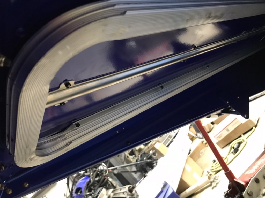

Why not put the recoil on a shelf in your shop, and get a lithium battery?Ultimate goal is to delete the battery and starter. I had them leave batt out even but I think before going that route I am going to wait for cold weather. This one pulls just as hard as a 2 cylinder. The demo I tried pulled very easily so could just be breakin not sure but easy enough to do later. I will put my 19000 mi original Viper battery in and the new one in the Viper. They are identical. I have been thinking of new one for Viper last few seasons so nice. This sled can always pull start it if issue anyway, Rope is also routed way nicer than my 800RR. straight shot and not rubbing on wires or coil mount. Batt is 14.6lb.View attachment 157449

Really like that exchanger with no connections at the back.Exchanger is full length of tunnel and at front. Should do well for cooling this little motor.

I am almost positive the battery and starter weigh more than recoil. Even if lithium battery which costs more $. I like free. Good suggestion though especially if I can’t pull it over when cold. ThanksWhy not put the recoil on a shelf in your shop, and get a lithium battery?
