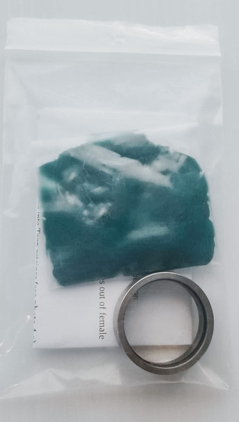

Got a picture on how the oring is supposed to seal the grease in at all? Looking at the ad pictures, I don't see how the collar and o-ring can hold the grease in place at all myself, perhaps I'm missing something though, thats why I ask.
KnappAttack
- Feb 19, 2004
- 5,006
- 6,354
- Welch MN
- 2023 Sidewinder LTX-LE
2017 Sidewinder LTX-LE
Turboflash just posted this pic in the other stubshaft thread. It confirms exactly what I thought and how I remembered the shaft went into the inner bearing for support, so I'm not going crazy or senile, yet anyway..... As you can see, the inside of the stub slides into the inner bearing, how does the collar go on to that inner portion of the stub shaft and still go into the inside bearing?
From what I can see of the picture on TD's website, the o-ring sits inside the collar. I can't for the life of me see how that collar could get used on the shaft and go into the bearing still. What am I missing and how does the grease get sealed into the splines and not get pushed right out into the engine internals?
Thanks Turboflash for the picture!
How does this collar with internal o-ring allow for the stub shaft to go into that internal bearing?
Can see the o-ring inside this collar that looks like its supposed to go over the stub shaft, but wouldn't that collar prevent the stubshaft from going inside the bearing? Where is the grease being sealed into the splines this way? I'm really missing some things here on how this works without it in hand.
