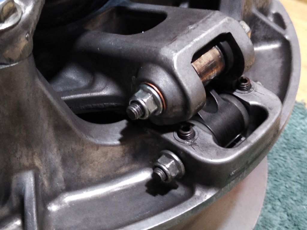

Copper washers huh, must be different thicknesses to accommodate the roller bolt being longer then the roller bushing, and causing that bolt head to hit on the clutch and eventually wear into that aluminum clutch. I found some steel washers that were a bit too thick at the hardware store. I then sanded each one down to allow .002-.003” play when fully tight. I was aware that if I went with one too tight, it could have caused that clutch pocket to move in and crack. Afterwards I learned on here, that I could buy some fiber washers to put on other end of that bolt to help absorb that hit/noise caused by the factory loose bushings/ bolts. Yes it does reduce some noise, but it still a noisy clutch. Mine were worn bad, on one of them I didn’t have to sand that steel washer to give it that bit of play. Hadn’t I done that it would probably have an 1/8” or more of play! Yep, these clutches should have simply added the set screws to the roller bush
I have 14400 kms on my clutch. Last year I added a set screw to prevent the roller pins from moving back and forth. I also use the Polaris spider shims to keep my button clearance at new specs. That helped, but there was still some noise. I recently added the knockout kit. My sled has never been this quiet.I agree my clutch’s STM and I’m on top of them just freshened them up one set has just over 4 k and on other sled just over 5 k but sure is quite. Keep fingers crossed

Nice I used to use rubber o rings on the pins for rollers back in the day helped a little bit.I have 14400 kms on my clutch. Last year I added a set screw to prevent the roller pins from moving back and forth. I also use the Polaris spider shims to keep my button clearance at new specs. That helped, but there was still some noise. I recently added the knockout kit. My sled has never been this quiet.

Yep, did that to mine 2-3 years ago but with steel washer on other end, bolt end because that’s where the bolt head indented the clutch aluminum. Following year I added the fiber washer under that nut and made sure to not over tighten all. Blue loctite is still tight every time I check those rollers. Thanks for the pic!View attachment 175249
I like the fibre idea...Yes, one in each side. If you Google "Yamaha sidewinder quiet kit" I believe Ulmer's sells them for $10. But please don't quote me.

Yes agree that you have the fix for that longer than the bolt, bushing! I remember a thread on here years past about doing that, and many thought it may cause that portion of the clutch to crack! Glad to hear of your fix, and your proving it, this is a way better method of holding that bushing in place (just like some Yamaha clutches of old)and then you can tighten bolt against it without forcing that clutch window to crack! I think my clutch had 7-8K on it when I first did my fix, it now has over 11K on it.I have 14400 kms on my clutch. Last year I added a set screw to prevent the roller pins from moving back and forth. I also use the Polaris spider shims to keep my button clearance at new specs. That helped, but there was still some noise. I recently added the knockout kit. My sled has never been this quiet.
Been there with the copper washers. Waste of time
