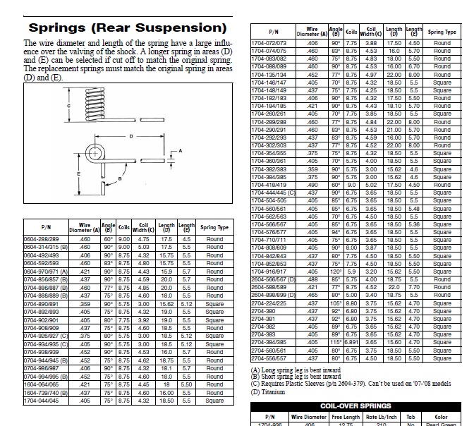

Steve,what is my stock spring for thickness is it .375 wire,as I would like the .405 be better for mine,now that my springs are sacked out.Here.16+ 137 Cat,Sidewinder and Viper spring (2704-026,7)is not shown in this pic. Goes from lighter to heavier. Cat #'s 1704-576,7 are the 14+129" stock springs. Looks like the silver lightest one is not available anymore. Chart is current.
Spring Chart
Old chart
You have the 2704-026,7 they are not in the charts. If you want stiffer go with the 129 springs. 1704-576,7 Your stock spring measures .400Steve,what is my stock spring for thickness is it .375 wire,as I would like the .405 be better for mine,now that my springs are sacked out.

The springs?
Part numbers are different tho
Hey hold the phone
Told you the cats guys were running a .375 spring.

Yes they have different part numbers... Kevin's at Port said his book says they are both 18.5 springs whatever that means... First I assumed it was pounds but that doesn't have with cats spec of 16.5 lbs on the 2704-026.... So now I think it's inches of the long leg....
