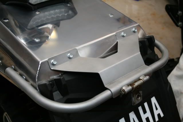

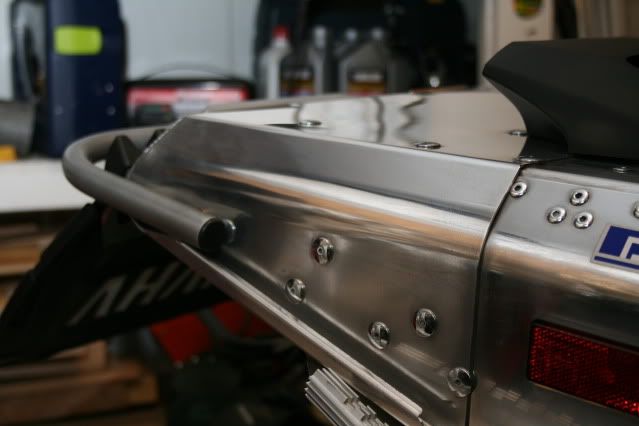

Hitch installed again, this time on the tunnel extension from Ulmer. Made it work and happy with how it turned out.
Hitch installed on tunnel extension.
Pic when hitch was installed before extension
As you can see there are minor differences but same results, a working hitch.

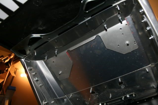

I drilled new bumper holes to accommodate the hitch. Filled original holes with large rivets and washers. The angle is different where it bolts(4) on to the new tunnel cap compared to the stock cap hence the extra holes . The hitch was designed for a stock Nytro so I new it wouldn't fit without a couple changes.
Reinforcement plate riveted on after I opened the angle to fit up under the new extension. I done this by putting it in a vise and bending it to the correct angle. Small adjustments at a time.
