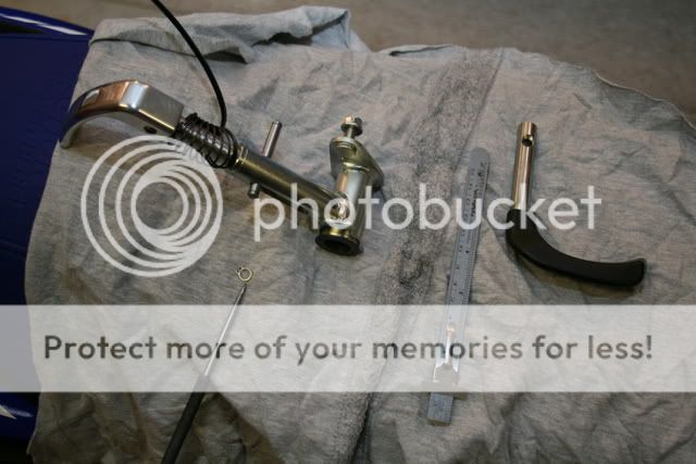

INSTALL BILLET HANDLE CR RACING
Well, I got my Nytro Billet Reverse handle a couple of days ago so I thought I'd share the install. Here's the link: http://www.crracingcanada.com/osc/home.php
First remove the plastic piece around the handle.
Now we can see behind the handle and figure out how this thing actually works. Look at that spring and small clips.
Remove this nut LOL and let this arm rest to the side. 10mm
The bracket holding the handle has to be removed and I marked the three bolts with a red marker. Two on top and one on bottom.
So far so good! Go ahead and remove these. 12mm
Now take the bolt running through the arm of the handle and slide the handle out of the bracket. The bracket can just hang for a bit. And look here.
Now the pin has to come out so I took a measure so when I re install it in the new handle I will be close. Remove the tiny clips on each end of the pin.
Well Goddo you are right, that pin is in there snug. So lets get it out. The pic is a bit dark but basically I'm punching the pin out on the vise.
Nope didn't really need a sledge but thats the first thing i seen.
Install the pin in the new handle now according to the measurement taken earlier. Make sure you put those c clips on either side. The pin is still snug but not as much this time around. Thats why they're there.
Slide handle through bracket, put bolt through to secure in bracket and bolt it back on sled. Reconnect reverse arm (for lack of terminology).
We are in business.
Now hopefully this will survive!

I did pretty much the exact same thing. I took the reverse switch off the mounting plate to make the handle come out of the mount easier. I didn't measure as carefully as you did...
Nice clean install...Very well done.

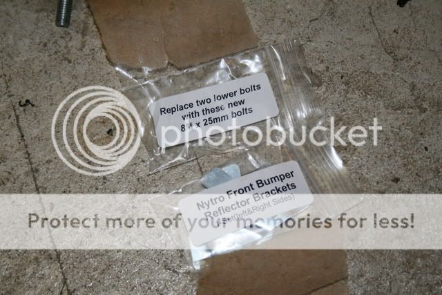

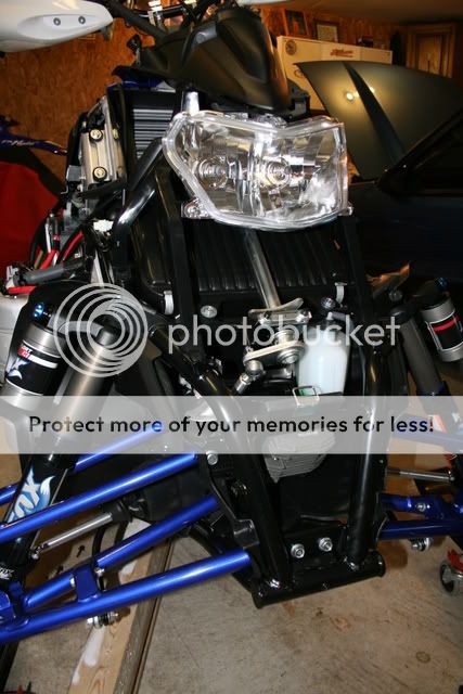

Here is the latest on my SE. I really liked the look of this Alum bumper on a 08 Nytro I seen last season so I got one. Part # SMA-8GLFT-BU-MP
It's a simple install. You have to remove the front nose of the sled to get at the two upper bolts. There are three screws to get this off. One on either side here and...
one behind the front of the skid plate. For ease of install, take her off.
Remove (4) 12mm bolts holding the stock bumper. My Lab is thinking enough with this sled already.
I also removed the reflectors here and put them on the new bumper with the brackets provided.
Here she is with no nose
Install new bumper! Same way you took it off. I don't usually have carpet under the Nytro, thats for my Mustang. LOL
