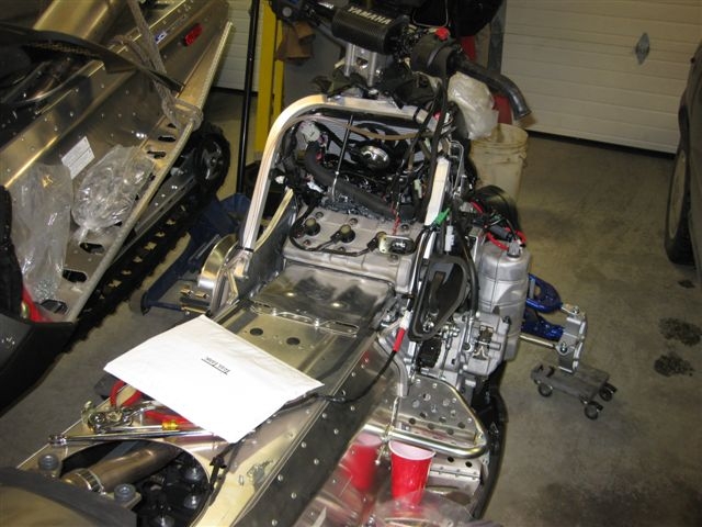

Started Install of Trail Tank from http://www.ulmerracing.com/
Remove plastic covers on rear. Couple 10mm bolts and a couple plastic pop grommets.
Remove a couple more bolts and seat comes off. Well on the way now.
I took out a bunce of grommets to remove the side panels. No use for these side panels with the TrailTank install.
Time to siphon out the gas out of OEM tank. Look more platic poppers. LOL.
more pics later...
more pics later...

Remove 2 nuts(12mm) holding tank down.
This is the Fuel gauge sending unit, un-hook that.
Remove the six nuts(10mm) holding the Fuel Pump and remove carefully. I just put this on a rag in bag and laid it up by Speedo. Oh, those o-rings expand almost instantly. TT comes with new ones anyway.
Now I removed the tank. You've seen this before but here it is again. Only this time it's mine.
Well here she sits for the night. Don't you just love takin things apart! Not even a mile on her.
After work tomorrow I plan to put the fuel pump on the TrailTank along with the sending unit and get this put back on.
Just imagine, all this gotta come off again when the exhaust arrives. LOL.

I just came in from the Garage (Trail tank install). I transferred the fuel gauge sending unit to the new tank(screws 2.9 ft/lbs). Didn't put the fuel pump in just yet.
I was curious how the tank would fit because I have heard of problems. It was tight but I had no problems. Installed tank then seat and holes lined up perfect and bolted on. I was impressed.
No trouble to tell that a lot of time has gone into this tank. Thanks.
