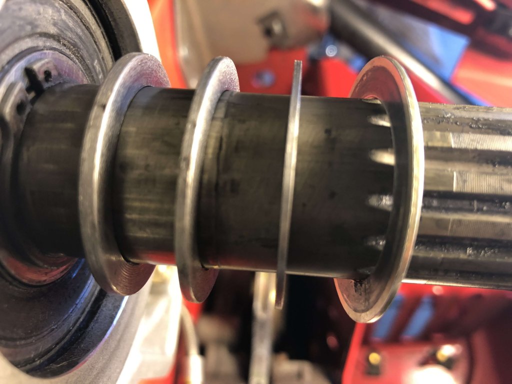

Got my stuff back from my machinist.....
Had him take off 4mm off hub, which makes it past flush when full shifted. And then I had him make me 3 shims, that are a slightly smaller OD then stock YAM shims. This way I can shim it wherever I want, and it will allow the shim to go inside if need be.
I had him make me a 2mm, 1.5mm, 1mm, shown in pic below....and then the stock 1mm which is larger OD.
I am now able to put my clutch anywhere from 58mm on up to 61. Where mine sits, I use the 1.5mm and end up right around 58.8mm or just under 59mm. Which I think is where I will put it now.

After moving the secondary inward, do you feel that the belt is doglegged at idle and rubs on the inner primary sheave?
Yes it does and it should. The belt needs to ride up the primary before it starts shifting in the driven and lines up better when moving, but at idle it has dogleg outward on the primary yes. You don't want it lined up at idle, but at 1:1 it needs to line up.
If its setup properly it will do this. Pull the shield off and watch what happens as the driven floats and the belt goes thru its shifting with the track off the ground. The driven floats out at lower ratio and higher ratio moves inward when higher 1:1 ratio.
