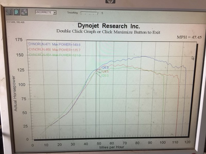

The PEFI muffler has amazing build quality and fit. It is also very quiet. It does give up a fair amount of hp over better flowing 2.5” mufflers. I chased a slight underboost condition at the end of last winter with a 1 particular tune and finally decided to swap mufflers and gained boost, rpm and reduced spool time. My sled was less impacted by the muffler on certain tunes than others. It fits the bill perfectly though for most riders as its quiet and flows much better than stock. Attached is a track dyno sheet from my buddys old zr9000rr comparing the pefi vs dd tech2 muffler. Red line is pefi muffler, blue line is dd tech 2.

^^^^^ this is the information I was talking about.

What’s the decibel difference between the 2? And how bout the D&D, is there the dreaded drone?

The dd tech 2 is probably one of the highest flowing 2.5” mufflers on the market and makes good power but wasnt designed to be quiet. I havent heard one personally was told it was quite loud. If your happy with the pefi muffler performance and sound then I wouldnt change it. Yes there are some gains to be had but at the expense of noise. I think the other popular 2.5” mufflers on the market fall somewhere in the middle of this dyno chart with hp and reasonable sound levels.

Interesting as I believe they claim 320 on pump gas with that muffler. 3” exhaust makes more power than all of the 2.5” but you can’t make them quiet.The PEFI muffler has amazing build quality and fit. It is also very quiet. It does give up a fair amount of hp over better flowing 2.5” mufflers. I chased a slight underboost condition at the end of last winter with a 1 particular tune and finally decided to swap mufflers and gained boost, rpm and reduced spool time. My sled was less impacted by the muffler on certain tunes than others. It fits the bill perfectly though for most riders as its quiet and flows much better than stock. Attached is a track dyno sheet from my buddys old zr9000rr comparing the pefi vs dd tech2 muffler. Red line is pefi muffler, blue line is dd tech 2.

Makes sense power= noiseThe dd tech 2 is probably one of the highest flowing 2.5” mufflers on the market and makes good power but wasnt designed to be quiet. I havent heard one personally was told it was quite loud. If your happy with the pefi muffler performance and sound then I wouldnt change it. Yes there are some gains to be had but at the expense of noise. I think the other popular 2.5” mufflers on the market fall somewhere in the middle of this dyno chart with hp and reasonable sound levels.
