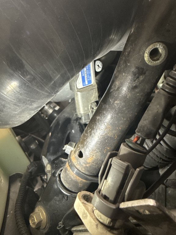

I could really use some help. Have a 2014 viper with push turbo and am trying to read the boost psi. All I can find is pressure and it just stays at 14.4. What am I missing? Have pod 300, pcv, and wide band 2

It’s reading barometric pressure, which is just fine. If you’re looking for 12 psi boost it’ll read 26 psi.

Make sure your map sensor is plugged in, it has to be reading boost or it’s not sensing boost in the PCV.Is there a way to get it to read out as psi of pressure? It never moves from 14.4 wide open or at idle

You need to go through the POD settings and make sure it is grabbing the pressure signal from the PCV.

Got the boost situation figured out. Map sensor ending up being bad. Now my next problem is my afr doesn’t read at all. Just sits at 10. Tried a new o2 sensor and still doesn’t move off 10 no matter whatYou need to go through the POD settings and make sure it is grabbing the pressure signal from the PCV.

Plug into the Power Commander with a laptop with the sled idling and make sure everything is reading on the computer. If it's not setup correctly in the PCV, it may not read on the POD.
