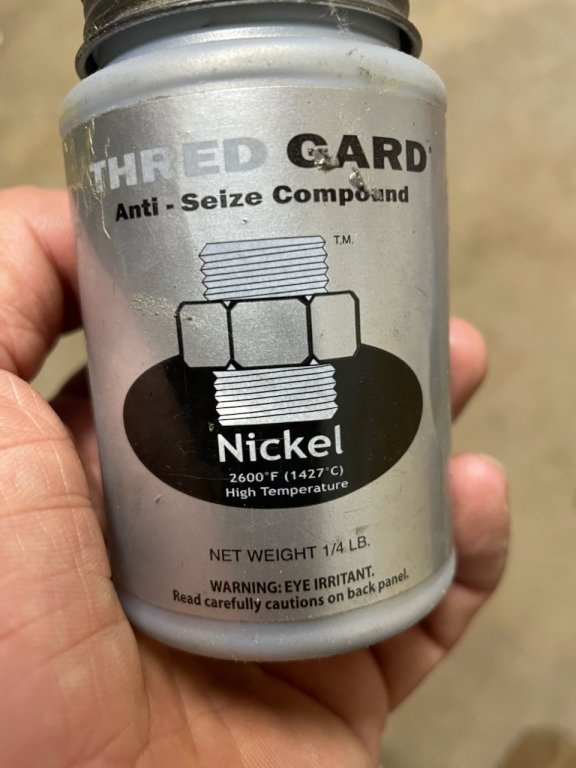

I found this on-line.
Good for 2600 degreesF

Looks like you got me beat! 2600 wow. that's some good stuff!

Got ya beat by 200°
I'm getting you used to getting beat
Cuz i'm gonna try to get to the UP next year & i'm hunting "Jon's that have Fun"

Dam!!that's a big enough bottle for all our to share!!LOLI found this on-line.
Good for 2600 degreesFView attachment 163146
