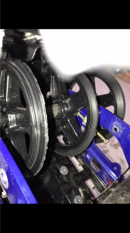

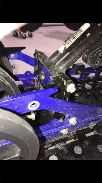

That's not goodView attachment 125341 View attachment 125342 View attachment 125343 Yes
I'm 220 dressed I wouldn't do it unless u are very light
WINDER1987
Nope wouldn't recommend it atleast keep the rod in i bent the metal back and am putting the racewerx one inThat's not good
