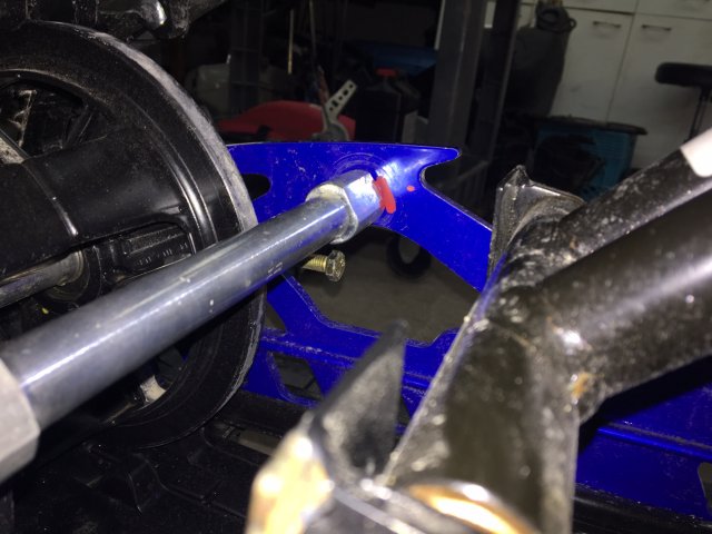

I wasn't happy with the transfer (or lack of) on my 137 skid, so the blocks are out for now.
1/2 inch socket on the impact and the bolts are out. Remove shaft and then remove blocks from shaft. Re-install shaft (w/ blue loctite) with bolts not quite tight, compress the skid to index the flat section of the shaft. I marked the flat with a paint pen and then tightened the two bolts again. It isn't that important that the flats are perfectly aligned to where the rear scissor will contact them; the first full compression of the rear end will take care of that. This just makes sure they are reasonably close...View attachment 124098
Hey Jim, was riding with Tony P. yesterday and his tuned up SW and my bone stocker. I had my blocks out and his were still in. We swapped sleds and couldn't believe how harded mine transferred with the blocks out. Such a small amount but makes a big difference.
