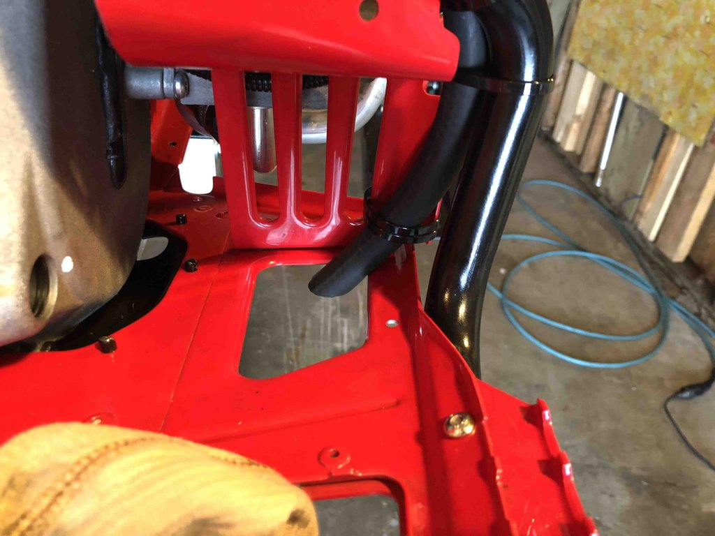

I copied this from Never Satisfied. It was easy and no leaks 2100 miles on my sled.
Never Satisfied instructions.
"1st off I eliminated the whole rollover system from the top of the oil tank to the intake tube. You have to pull off the air plenum to do it. I put a cap over the nipple on the intake tube, FYI it is very very tight to the steering post, the OEM clamp was actually rubbing on the post
. So with that I had 2 tubes left over, the one from the tank to the valve the other from the valve to the intake. That second hose has a nice 90 degree bend which fits perfectly on the oil tank to direct the vapor down to the floor board. I got a $.29 plastic union and added some 5/8" hose to get it out of the floor board area. I zip tide it to the toe hold to keep it out of the way of my foot. Simple and cheap."
"1st off I eliminated the whole rollover system from the top of the oil tank to the intake tube. You have to pull off the air plenum to do it. I put a cap over the nipple on the intake tube, FYI it is very very tight to the steering post, the OEM clamp was actually rubbing on the post. So with that I had 2 tubes left over, the one from the tank to the valve the other from the valve to the intake. That second hose has a nice 90 degree bend which fits perfectly on the oil tank to direct the vapor down to the floor board. I got a $.29 plastic union and added some 5/8" hose to get it out of the floor board area. I zip tide it to the toe hold to keep it out of the way of my foot. Simple and cheap."
You might want to check out my pics, most of us all run a longer loop. Your short hose/loop will sure leak oil fast if rolled....something a longer hose design reduces.
Be sure to use Fuel line(not heater/coolant hose)
Dan
