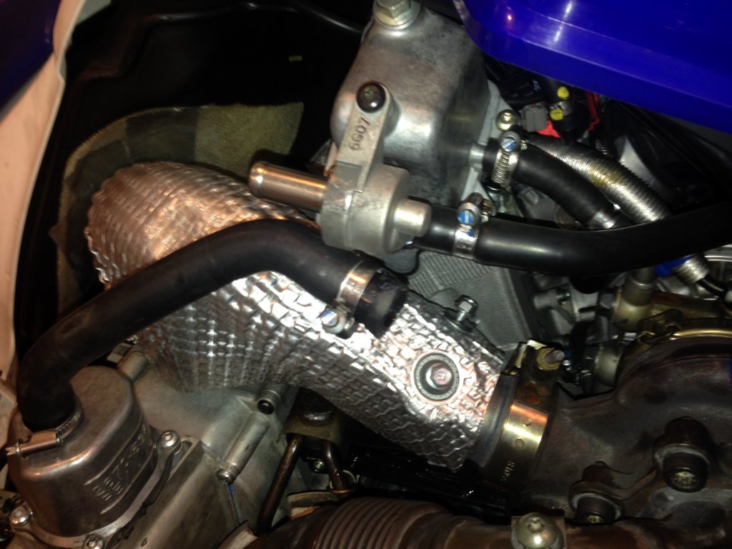

I know this has been mentioned a few times but it deserves its own thread.
A common problem we have been seeing on the sidewinders is leaking oil tanks. The leak is from the seal between the oil tank and chain case.
When I seen my leak first thing I did was take the tank off and reseal it. This fixed the problem at idle until the first time I drove it on the truck.
What Has been found is , it is not the oil tank seal that's the problem but there is pressure in the tank Caused from a malfunctioning roll over valve. Since the seal is only silicone it does not seem to handle the pressure well.
Take a look at your oil tank for leaks. Run your hand under the tank down where your foot would be when your riding.

The valve is located above the oil tank , the large black vent hose goes to it.
You can defiantly bypass it , but it has a purpose . If you're sled goes upside down the oil will fill up the air box and I geusse there's a chance of fire if oil gets on the exhaust.

It seems to be a sealed unit. No real way to take it apart.
When I removed it it seemed like the valves was stuck. After I blew through it a few times with lp air it opens just like the new one off my buddy's sled

If you have an oil leak at the seam , you need to re seal the case. Once the silicone is compromised it's nfg.
But I'm thinking it's caused by the roll over valve sometimes.
If you run the engine with vent hose off. You can feel there's a tun of pressure coming from the oil tank, so if the valve is sticky I think it over pressurized the tank and that silicone gasket just doesn't hold up.

Once you run the sled with your finger over the vent hose youll understand how much pressure comes out of the tank. A small hole isn't going to change much.
I think there's a reason to have a slight pressure in the tank to keep the oil from getting pulled out.
Still a poor design to seal the oil tank with silicone.

I also recommended threebond until I used it. It didn't handle the pressure on the tank at all.Joe we were told to use Threebond Liquid Gasket 1194 for sealing the oil tank.
1194 runs to much when applying in this application. Rvt silicone seems to Be the best choice since it sets up solid. There's a lot of gap in places on these oil tank flanges. Not a good seal at all. I blued the two faces when I had it apart, the flanges aren't straight to each other. That's why silicone works because it actually can take up air gaps in the seal.
