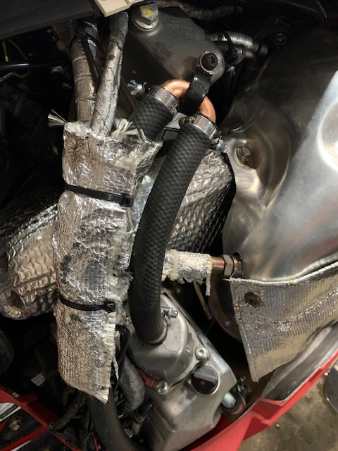

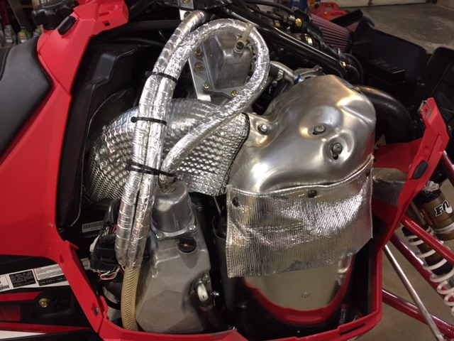

I'm in the process of installing roll over delete after a blowout and wondered if i could just cap off hose coming out of the roll over as it looks like having to remove a bunch of stuff just to cap off the nipple at the turbo intake.This is what I’ve done to get rid of the problematic valve. Just a hardware store 5/8" ID hose wrapped with foil heat tape, looped it up and over down to under the running board. Let bottom hang and inch or two below the board. You can see how much blowby you have also.
I plugged the line where the stock hose went into the turbo intake with a rubber 3/8" ID cap stretched over the intake turbo tube nipple and clamped.
Now the intake is not getting that blow-by exhaust and no worry of the supposed factory "roll over" valve sticking shut and blowing out the oil tank seal again.
It worked fine on my turbo 1200 Doos for years this exact same way.
I was going to install a 1200 roll over valve but haven’t yet as the space to do so is pretty limited. It’s been over 20 years since I’ve rolled any machine and am not to worried about it not having a valve, for now anyway.
Not telling anyone to get rid of it, but I’m not going to have my oil tank seal blown out on a trip. I’ve already sealed it once as it was leaking.
This is my latest creation as one sled I did last year had a hose kink at the loop. Don't use heater hose either as it is not compatible with oil, make sure to use 5/8" fuel or oil line.
I assume your talking about the newer machines where they run the to the air box?
It’s your machine and you can do whatever you see fit.
I personally rip the excess valve hose and any added hardware out from under the hood and cap off the hole in the air box on the newer machines to eliminate the garbage under the confines of that upper valve cover area.
If you feel better just capping it at the valve then that’s fine too. Just makes life easier changing plugs getting it out of way tossing it aside or in the garbage right off the bat IMO.

Thanks for the reply,it's a 17.

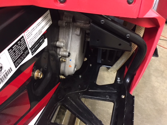

you are correct, the 7000 is more of a touring sled, big and heavy but they share the same motor crankcase etc it does have the breather box/oil separator. I have seen some people attach a t connector and re route the breather in a loop down to the footwell. I may install a four stroke solutions roll-over valve in the summer when I have access to better delivery (we only get canada post way up here in the north) but for now I think I will try re routing the hose that goes from the separator to the air intake, I just didn't know if this was really a viable option.The 7000 is the same as the SR Viper, right? only different plastics. In that case, it should have a breather box/oil separator over the oil tank that could give you some trouble over time, the moisture causes it the ball inside to freeze up. If memory serves, you will have two hoses to the oil tank (one of these may have been rerouted from bottom of oil tank to the mag cover) and one hose to the intake. I've been suggested to get rid of the box and just connect all hoses in a T-connector and route the "breather" in a loop and down the footwell. I did end up installing a FourStrokeSolutions roll-over valve, and routing that breather hose out from the intake.

You can't bypass the rollover valve on the SR Viper/AC 7000 series sleds. You must have the black box still intact and working. The hose going to the air box can have a hose slide on it and have it pointed down towards the bottom of the belly pan, but you can't completely eliminate the black rollover box.
I eliminated mine my using a Sidewinder oil tank and ran breather hose like Sidewinder guys do. Only reason I did it was because I had one and mine was destroyed when silencer blew out and caught sled on fire. Using Winder tank caused issues with bodywork. It’s wider so could not use Dzus fastener on bottom since it hit tank. Also had to fabricate mount for thermostat/Cap housing. Best advice I can give is don’t overfill your oil and dress ready to ride when starting sled. When red blinking light goes out on cold start go. Slowly. Steam from idling causes that valve to stick.
