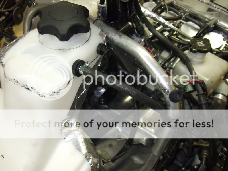

UPDATE January 2. - Adding heat shielding materials to the fuel tank.
The Rev gas tank needed some heat shielding before I can install it in the sled. I reused the shielding materials from the stock gas tank. I cut out pieces to fit the REV gas tank and used double sided tape to tape the heat shielding material to the REV gas tank. I think it turned out pretty good.
Done. The tank is ready for install.
Got an email about the silicon hoses and aluminum tubes I ordered, parts have been shipped and should arrive at my door some day this coming week
It's turbo time yeeeeha - with those parts in I'm able to get the sled ridable in matter of days hahahahaha

UPDATE January 5. - Installing the REV fuel tank.
Today I installed the REV fuel tank. First I installed the filler neck tube into the tank.
Connecting fuel line and adding a hose clamp. Also connected the wire from the fuel gauge pickup to the harness.
Next was installing the fuel return line coming from the fuel pressure regulator.
The tank installed on the sled.
Need to tighten down the two nuts on the rear of the tank and add the gas tank vent line and she's ready to get some new fresh fuel. MAN I'm closing in on fireing up the sled.
