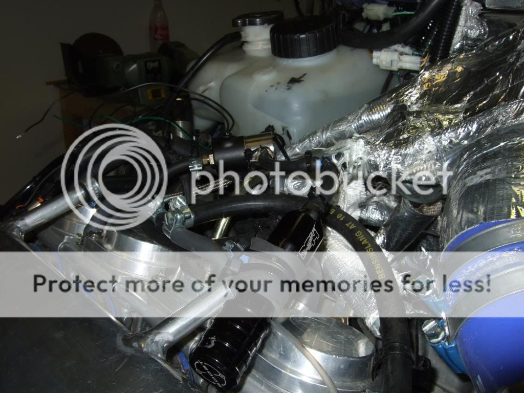

Boost controller, install guide, failsafe solenoid and other parts ready for install.

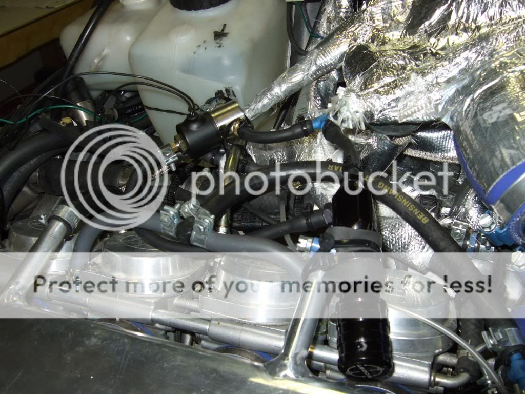

Here's how the install went. Install a T on the line coming from the compressor. Cut a piece of line to go from the T to the IN nipple of the failsafe solenoid. Install the line coming from the wastegate to the OUT nipple of the failsafe solenoid. Cut a piece of line to go from the T to the IN nipple of the boost controller. Cut a piece of line to go from the OUT nipple of the boost controller to the top of the failsafe solenoid. Here's a few pics of the install.
Last I had to connect the failsafe solenoid to ground and to the green signal line coming from the failsafe controller.
Will turn up the boost this weekend. I shoot for 16-18 lbs for starters or as high as my clutches will allow me to go. Finally done building on the sled, who would have thought it would be late April before the build was done. I have a few more week to ride and tune the sled before the trails close down in May.
