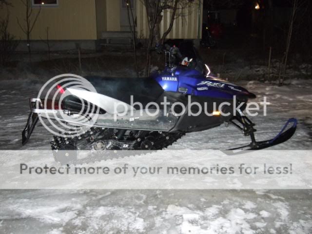

UPDATE December 16. - Turbo testride 2, a ZX-2 review.
Last weekend I rode both my '05 RX-1 Mono, and my friends '08 FX Nytro RTX. Today on the same trail, riding my ZX-2 equipped Turbo RX-1 a lot harder than I rode any of the sleds last weekend, I find the ZX-2 to be a superb skid. It is way softer over the stutters and small bumps than the FX Nytro RTX, and it takes the big ones like they where not there at all. The RTX didn't bottom out either on the big ones but it felt a lot stiffer. The ZX-2 doesn't feel stiff at all and it still doesn't bottom out, it feels soft all the way sucking up the nasties with ease.
I didn't ride the FX Nytro RTX past 50 mph over the big ones, at 50 mph the Nytro RTX handled the bigh ones just fine. It will probably take a lot of beating before bottoming out. What I found is that the RTX can take a beating with ease but it feels stiff until you really nail it over the big ones at speed. Slow to medium speed is kinda firm on the FX Nytro.
On my ZX-2 going 50 mph over the big ones were no problem either, no bottoming and if feels a lot smoother and softer over the big ones at speed compared to the FX Nytro RTX. The ZX-2 is soft all the way from slow riding to speeding over the big ones without bottoming. Again, I'm happy with it
My front end Fox Floats are set at 50 lbs at the moment, too soft. I will have to increase pressure up front to match the ZX-2. I think I will go up 10 at the time until I'm happy with it. They did not bottom out one single time, but I feel that they are too soft compared to the rear end, a little too much dive into corners for my likings.
Turbo power are nice Temps today were +6C or 42F. This caused the AFR to go way low. When we get a more normal cold temp outside I will start adjusting the pilot screw in a 1/4 turn at a time until idle and slow speed AFR #s gets up in the 13s or something. Acceleration from a standstill was fat, the engine wouldn't run clean until getting some boost. From slow speed giving it WOT, worked great, a little low AFR tho.
Clutching: Hard to tell with the temps and conditions on the lake. WOT from a rolling start and the rpms went 10500 and stayed there. Too fat down low to get any useful info giving it WOT from a standstill. More clutch testing has to be done when the carbs are in tune.
Lost a little coolant, can't tell were it went. I found out when at home and the engine was cooled down, coolant sat at the bottom of the can. I took a cup of liquid to reach the cold level line. It might just have been a air bubble trapped that finally got blown out. I ran the sled a few full power passes on the lake, upto 208 kmt or 129 mph on the meter. I could not find and signs of coolant going out the overflow. I have now added half a bottle of radiator fix into the coolant to stop any leakage from my left side heat exchanger. It haven't leaked any coolant on my garage floor, but it may leak when the coolant system gets pressurized. I pray that I have not lost my head gaskets, again.

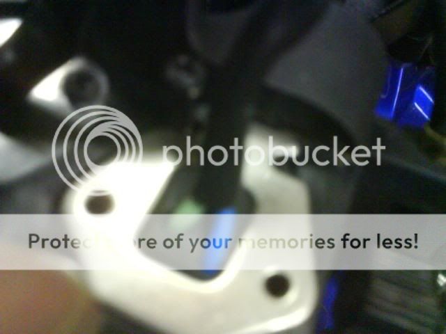

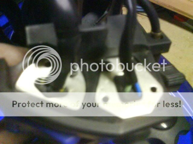

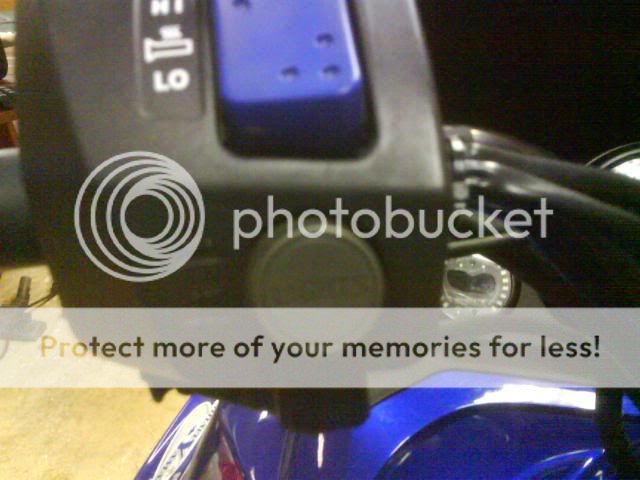

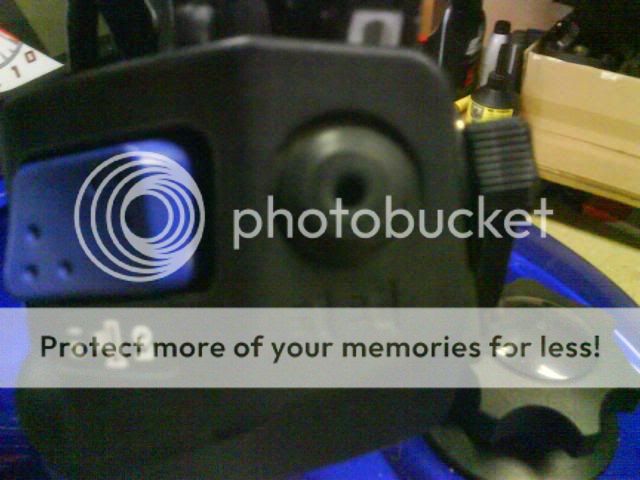

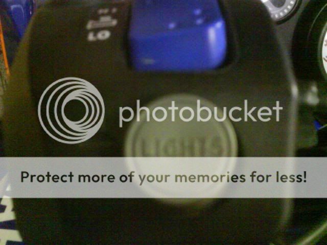

UPDATE December 22. - Replacing broken HI/LO headlight switch. Adjusting Fox Floats.
I got the HI/LO head beam button from my dealer
Your dealer may say that this part is not available and you have to buy the whole assy, you do not. I got this part from my dealer. He contacted Yamaha about this and he got the button in the mail a few days later, great service from Midt-Finnmark Motor AS (my dealer) and Yamaha Scandinavia for sending me a replacement button.
Sorry about the pics, I forgot my dig camera and had to use my cellphone camera with bad quality pics as a result.

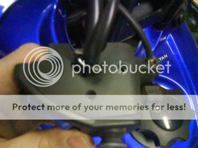

Then on to replacing the broken button. First remove the two screws underneat, on the carbed sleds it's close to the chocke lever.
Then remove the three screws shown in this pic and remove the plastic plate.
Remove the zip tie holding the wires to the switch assembly. Then unscrew the small screw placed in the upper left of the small metal plate.
Remove the headlight beam HI/LO switch from the assy.
Remove the broken HI/LO button.
Wiggle the new HI/LO button into the rubber booth.
Slide the HI/LO swithing mechanism into place. The button have a groove that the switching mechanicm will slide onto.
Install the metal plate.
Tie the wires together to the switch assy with a zip-tie.
Reinstall the plastic plate.
Slide the switch assy onto the handlebar and install the two screws holding it in place.
Done.

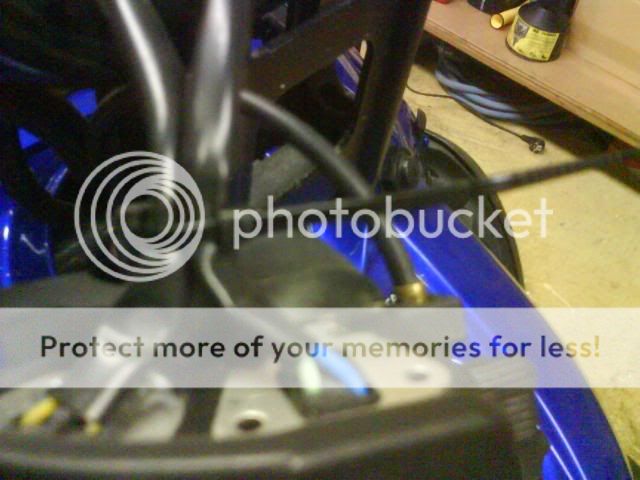

Adjusting Fox Float pressure.
Last work done today was adjusting pressure in my Fox Floats. First I jacked the front end of my sled up enough to get the skis from the floor. Then I removed the caps from the filler valves and connect the pressure pump to the Fox Floats. I found that the pressure was down about 2 lbs on both shocks do they leak or is this normal? Do they have to be adjusted on a weekly basis to keep pressure consistent? OK - they were at 48-49 lbs, down from 50 lbs. I decided to pump them to 70 lbs. Reinstalled valve caps and lowered the jack. Done.
Weather is now nice and calm after a few weeks of gail to hurricane force winds. A few houses were badly damaged by the last hurricane Rita, and a lot of pine trees had to give away as well and just broke off or tipped over pulling their roots out off the ground. I had no damages done to my properties as far as I know. I haven't checked out my cabin by the lake though, but it was shielded behind a hill so winds should pass over head of my cabin. Temps have dropped down to -6C or 21F. We have got a few inches of snow at sealevel and a lot more in the mountains. I wish more snow and cold weather for the rest of the season as my christmas gift
