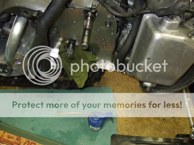

There are collars with oil rings on the inside, on both the driveshaft and jackshaft. There are also oil seals behind both the upper and lower chaincase bearings. The upper collar and oil ring didn't come off the jackshaft, that's why it was not a part of my install writeup. The lower collar and oil ring was installed as a part of the track and driveshaft install.
Both collars installed on the jackshaft and driveshaft are shown in this pic.
