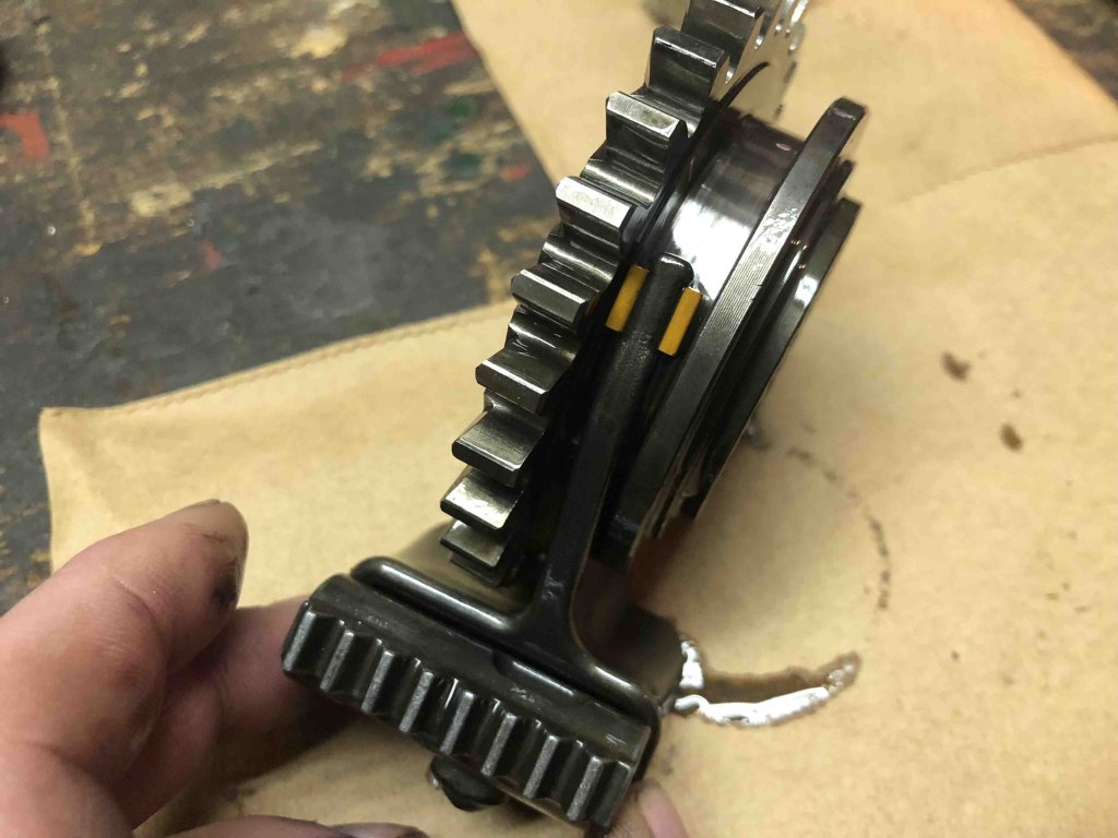

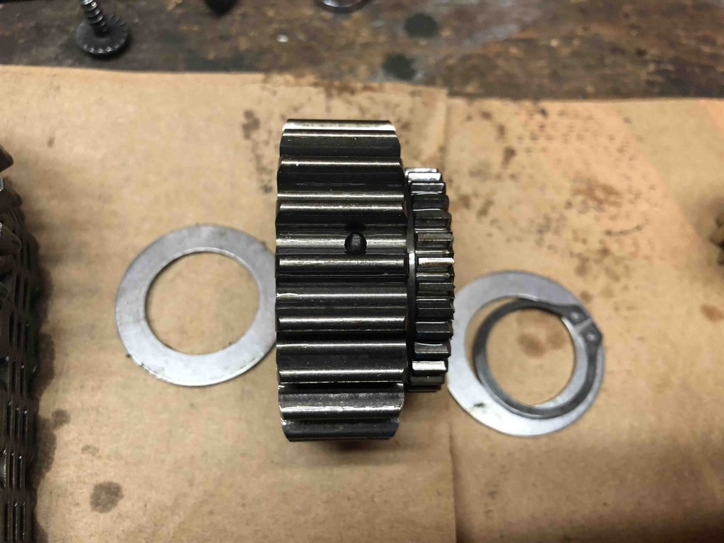

A few of us have found this odd from the get-go. The top gear, only spins on the Jshaft at that bushing when sled is put into reverse. Otherwise when sled is in forward, that bushing does not spin on the Jshaft, as the top gear is meshed in with the sliding reverse gear.Ya that is correct, new gear has 3 holes and they are drilled right thru. We shall see if it helps with the life of this bushing!
What I believe happens is there is some play when in forward as the top gear is being driven by the reverse gear when meshed into it from the side. Im sure this is why these holes were never felt to be needed initially. But for some reason that bushing gets worn, and so it must be due to the side mount of the reverse gear, and then the play gets worse over time.
Sure cant hurt having holes....Just funny the 18s had one hole that was never drilled thru completely, almost like it was a screw up.
Dan
Top gear shown without reverse gear/sliding fork installed.....the small teeth on outside are where it meshes into the reverse gear/sliding fork to go in forward direction
This is the reverse gear and sliding fork, which sits right beside the top main gear.....shown in forward direction/meshed into top gear
The reverse gear/sliding fork below slides left(forward) or right(reverse), meshes into top gear(left/forward) un-meshes(right/reverse)
One oil hole not drilled thru...stock'18

I have had mine apart twice now, the design seems to work well for me so far....Unlike the 2012s with all their issues.Dan, the pads on the shift fork seem like a good idea to you? Mine broke off last season causing the gears to pop into a neutral like position. But could hear the sprocket gear rubbing up on the reverse gear making a nasty grind noise. Now I don.t trust it.
The key to those ones that may pop into neutral is.....you need to read the manual closely when installing the actuator and reverse solenoid. Basically you want to be turning that solenoid motor Counter clockwise as you are trying to install the 3 bolts. Turning that solenoid motor CC is pushing that fork/reverse gear to the left, which keeps that reverse gear meshed into the main top gear. As soon as that pops out to the right, its neutral.
The grinding is the small teeth(inner) of the reverse gear and main top gear trying to mesh.
Dan
