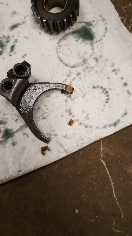

ROCKERDAN
OCD Sledhead
- Oct 8, 2005
- 7,496
- 3,609
- 2,003
- Other
- '18 RTX 50th "Winder"
Sure I would think so.Would this being worn out/broken be causing the sled to keep poping out of gear?View attachment 138952

I hope so just ordered a new top gear and reverse gear. They meshed hard enough to wreck both
This happened to my winder last march. My friends did this last week. both had about 2000 miles on them. Top gear has about .080 of slop and thats a lot. The gear can move ways it is not supposed to and breaks the fork pads. Also can push the circlip behind the gear out of its grove and the chain will grind off aluminum from case. Mine just broke the pads so it would pop out of gear and grind. Shut it of and restart and it was able to drive back but popped out several times. my friend moved the circlip and was not able to drive it. I have heard some say just replace the top gear every year. Not a good design in the $15,000 machine!
- 5,495
- 4,164
On my 18, I installed both washers that are located beside the top gear on the inside only. I then had a washer that was half as thick that I put on the right and the clip would still fit. This helped to keep the splines further engaged.
But ya, this chaincase needs a major re-tooling.
