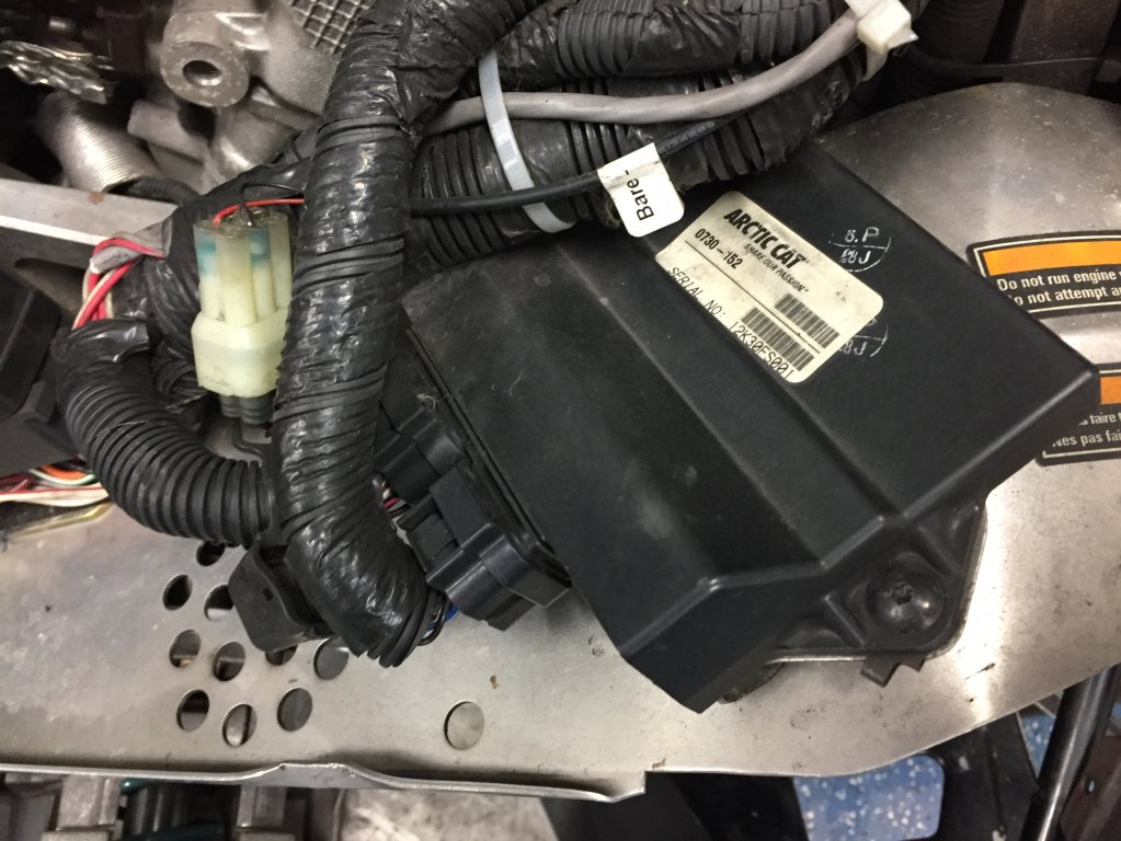

Anyone know what brand ecu this is? Sure looks like a Mitsubishi to me. 12 Cat turbo

Oh anyone know who makes this?Anyone know what brand ecu this is? Sure looks like a Mitsubishi to me. 12 Cat turbo
