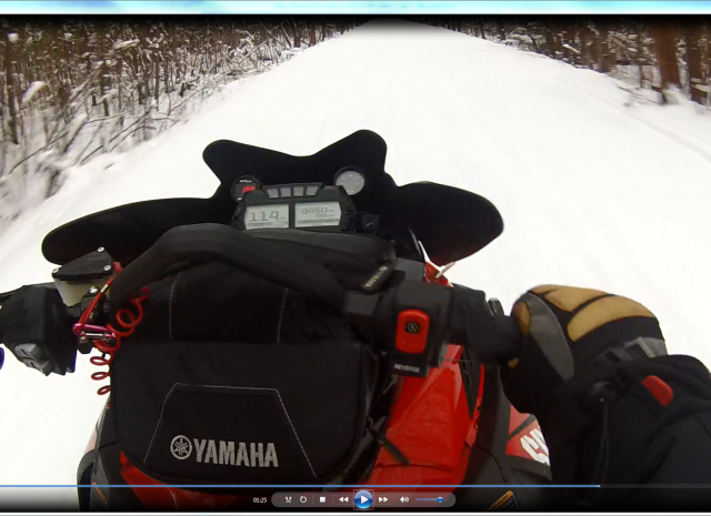

Thats nice Yamadog but you have a Turbo. Lets keep this NA sleds. Let us guys have some fun too!I am getting easily 114 on short runs (not long WOT) out of mine at 8450 rpm on snow now at 7#'s of boost and it is clutched for 10.5#'s so hoping 123 on snow and 128 on ice wen I flip the switch.
PCV with Ulmer base map modded by me.What tuner are you using?

But yours certainly isn't NA. Your cheating!I am getting easily 114 on short runs (not long WOT) out of mine at 8450 rpm on snow now at 7#'s of boost and it is clutched for 10.5#'s so hoping 123 on snow and 128 on ice wen I flip the switch.
