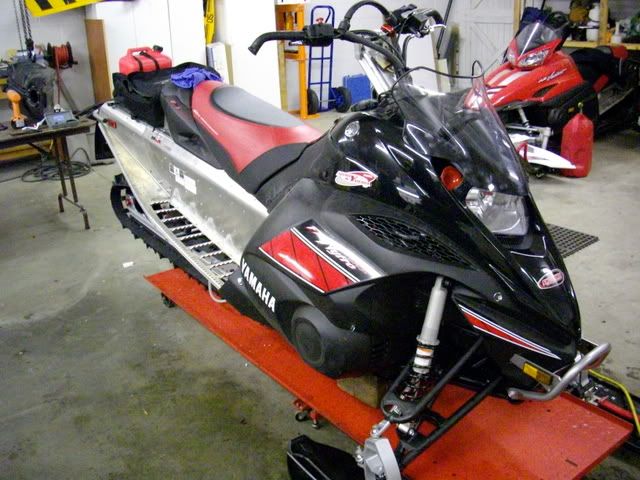

The TANK has arrived!!!!
Talk about just in time delivery!!! We got our first dumping of snow and in comes the final component to the big mod. This tank is custom made by

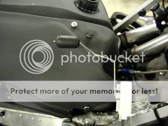

Since I have to bend up the float arm to work around the turbo depression, my gas gauge will read 'full' until I get down to about my last 3 gal or so. Then the gauge will start functioning normally telling me I'm near the end of my supply.

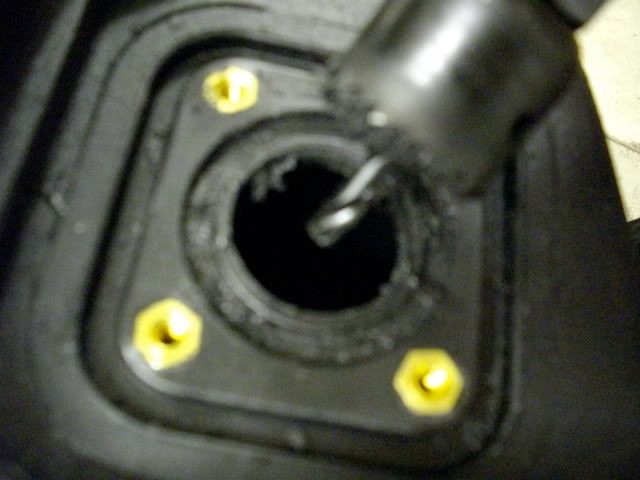

To get started on the install, I'm going to drill out the hole here for the fuel gauge. I'm going to use a 1 1/4" regular hole saw to do the job ...
It's nice to have a pilot dimple molded in the center to help make this job easy ...
Once the hole's cut, clean 'er up and you're ready for the next step ...
Here you can see the new shape of the float arm as I've re-bent the extension wire there. This as I said will only start to function when I get down to my last three gallons or so - until then, my tank gauge will read full.

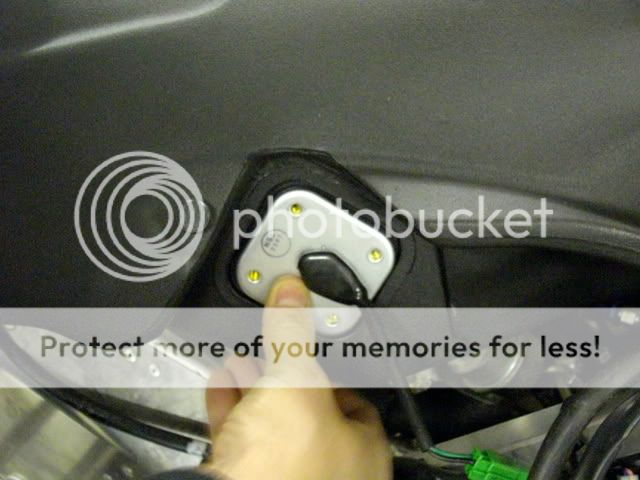

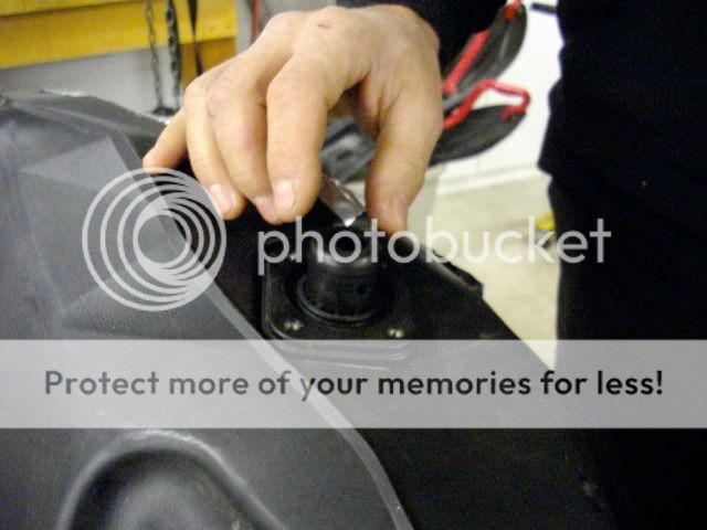

Now with everything ready to install, I add the 'O' ring that comes with the tank and secure the fuel gauge assembly ...
And here's what the float should look like as you look back inside the large fuel pump opening ...
trail tank (click) which specializes in high capacity tanks. For instance, you can change out your stock 8 gal tank for a 10 gal tank. In our case, running the turbo just behind the engine, we had to have a tank specially made that will accommodate the space of the turbo itself ....

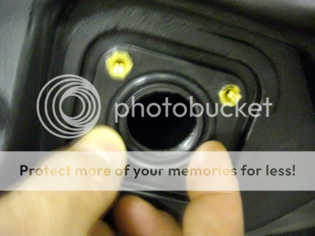

With the fuel gauge attached, I then add the fuel pump assembly ....
and the breather line ...
With that, you can wiggle the tank in place and bolt it to the tunnel. It fits PERFECTLY!!!!!
I'm adding a new FBI black tank plate. Fit it in place, add the rubber tank cap, and secure it to the tank with the screws provided ...
Trail Tanks has provided a new way to attach your top & side panels to the tank. You'll use a threaded knobs instead of these things. I'll keep all mine as extras
They'll go on like so ....

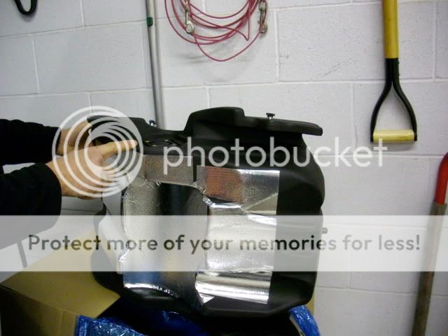

I would suggest leaving the brack in, and leave the heat tape on the tank...fuel and heat, is not something that should be messed with.,..
we start my install today, and I will probably even get a turbo blanket just for grins...and peace of mind (yes being anal...)

Travis supplied me with an additional heat blanket to apply to the back of the trail tank above and beyond what they already did for heat shielding. I also have the turbo heat shield on. What I can't decide is if I should take it all apart and apply the heat blanket material he sent in addition to what is already there. I am planning to ride it for a week and take it off and check it. Sort of some R & D to see if the tank can handle the heat. If there is any thermal damage I will report to Travis the need for the additional heat shielding.
