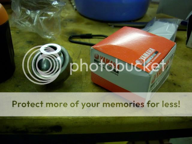

The RECALL INSTALL
Have you heard the news? We've had our first recall on the '08 Nytro with regards to a new plate adaptor for the left front footwell and replacement front lower A-arm ball joints.
I called my Yamaha dealer and had the parts shipped in. Here's the bearing part number ....

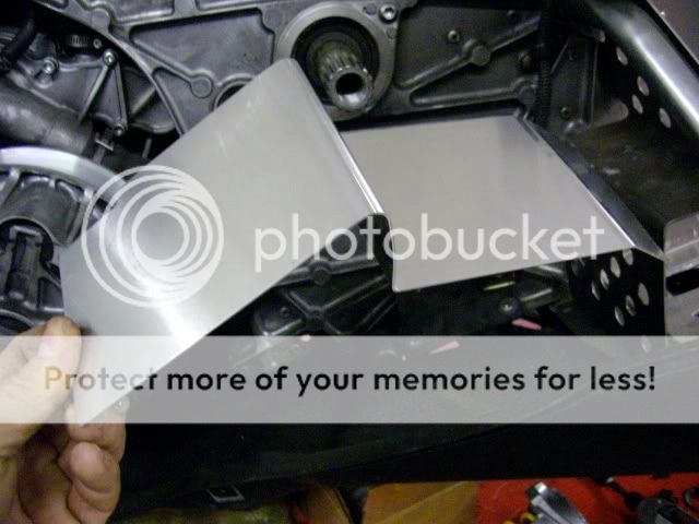

and here's what the footwell plate looks like ...
So I wondered 'what's the matter with these ball joints'?. When I took the old B-joints out for inspection - I found out immediately! Both of them had nearly an 1/8" of slop and were ready to completely fail.
