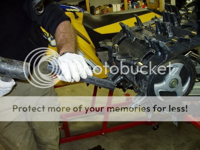

Suffering from .... excessive Hyfax wear?!?
After my first tank of gas and going over a general inspection, I noticed that the hyfaxes were GONE right there by the front bend in the rails. The dealer says that it's not a warranty issue?!?
Check this out when I pulled them off .....
Hmmmm .... looks shot to me.
First thing was to pre-drill my new skids with 1/4" holes and I placed them in the areas of excessive wear ....
The theory here is that snow will collect in the holes and then proceed to melt down (and therefore lubricate the plastic) when things heat up on the trail. This trick has worked for me on other makes.
Here's another "heads up". I have to say that re-installing new plastic was a chore. Man do they fit squeaky tight. I used regular axle grease not only on the plastic, but also on the rails to help these things slide on better. Still, there was a lot of coaxing with a rubber mallet to get them on.
Glad to see the driver windows on the track were wider than the hyfaxes for the removal/reinstall. I cut one of the worn skids to use as a punch for the final 3" .....
AND NOW, FOR THE FIX. I stuck a 6x6 piece of timber under the front suspension and lowered the weight of the sled down on it. This compressed the limiter straps. I undid the top nuts on the straps and took up two holes worth of slack to help bring up the front of the skid about an inch or so.
Also, I backed the track tension-er bolts off about 4 turns each. When I pick up the back end of the sled, I like to see at least 1" of sag in the middle of the rails as adequate track tension.
THE RESULT .... two tanks of gas later and the hyfaxes still look like new. I wonder if the dealers are aware of this issue. If you've got excessive wear on your skids, this adjustment will help .... a lot!
This will do for now, but I've got plans for a whole new rear suspension install this summer!

Mt and TTabs, Good catch on the service manual. There's some fun reading!
T- Nice job on the hyfax. I was wondering why they ran the tracks so tight. Aren't they extro drivers? We should be able to run them fairly loose.
