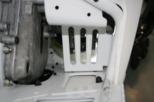

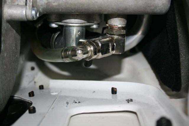

Pic with toe kick removed:
With the toe kick installed:
Looks great TD! How does it work? Is there a knob you turn to open flow? Where does the hose go to?
If you look closely at the underside of the valve you will see the end of a black lever. This lever operates a 1/4 turn ball valve and is held closed in a detent by a spring. I positioned the valve this way so that it is protected and still has good access. It is accessible with your left hand reaching between the toe kick and the chaincase
