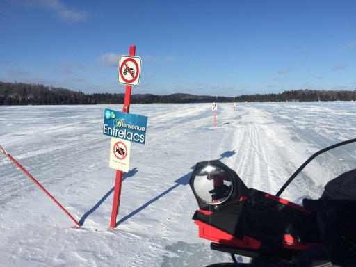

When you need scratchers you need them. If it beats up the ski so be it. If it gets lost oh well. I rode a VERY icy weekend after a hard freeze last March in Quebec with no scratchers. When my Winder went into limp mode I rode it harder to get it to cool down. I would rather have had the scratchers than not. I rode another trip after that and it worked great and I didnt lose any parts of the scratcher. That pic of the scratcher on the ski is the other day in my garage so no noticeable damage to anything so far. Your mileage may vary. Snomoin aint cheap but it sure is fun. That is the Barn of Parts bracket. The other scratcher is on my Attak.

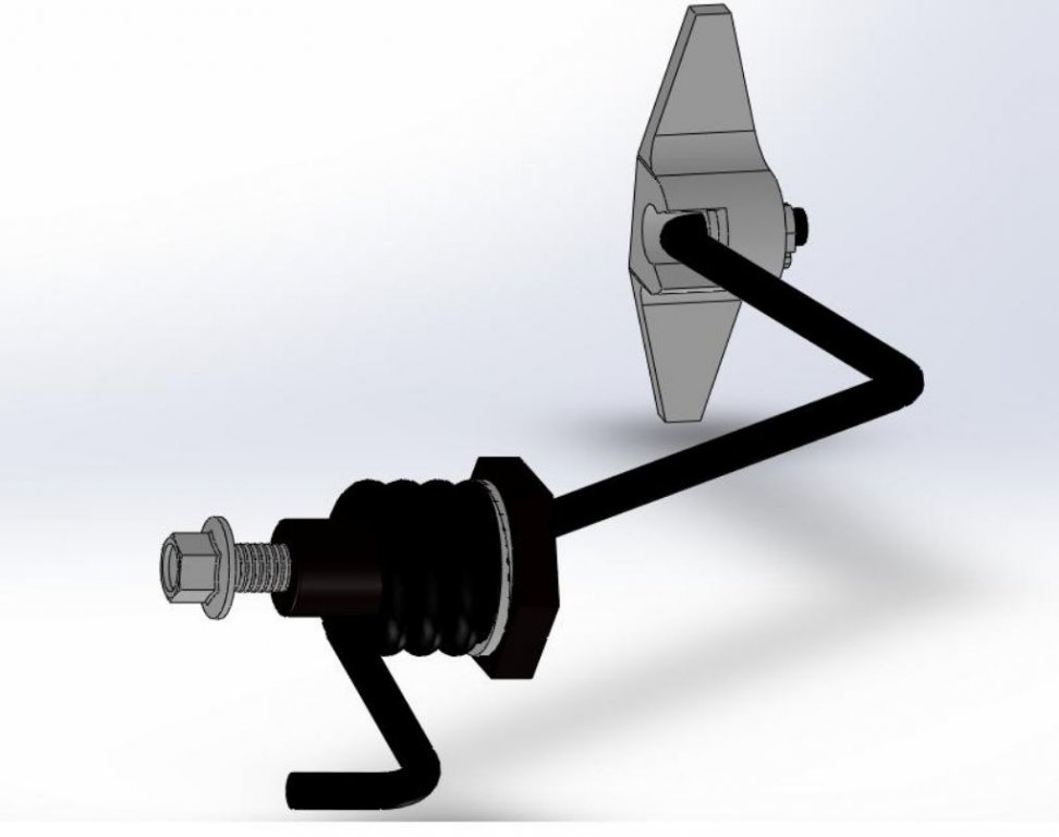

Dan ,if you use these add a fender washer on both sides of the ski where the bolt goes thru for support .Also,if you look at the pictures i sent you ,i made different up holds as the ones that came with the scratchers didn't hold the scratchers up when not in use in real bumpy trails .

They are made by over the top performance&are called ice storm ski mount.they are able to be used in reverse.i have an antique sled with aluminum ski mounts.(rx1 converted to 136 mono) im sure they would work on an all plastic ski

Do you have the SKI mounted kit, or the Skid/Rail mounted kit? I notice OTTP offers two designs, and they each cost abit diff.
The pics I posted are the SKI mounted kit.
It looks like some people have and were mounting the skid design to the ski, using a separate hole and bolt, where the ski design in pics, bolts onto the main ski/spindle bolt.
