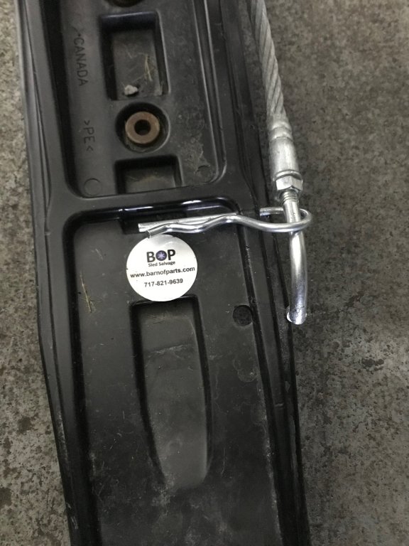

I ordered some of these to test. They work ok, however I was not overly impressed. Lots of slop in the design makes it tough to keep down pressure. If rib thickness is not real thick on the ski such as the 14 cat ski i have on my winder I found the rib would flex and minimize the ability to maintain down pressure. I was drawn to the ability to stow them, however I also was not able to stow them up on the ski. Stationary they would stow, but there would be interference when suspension cycles and ski turns.
I still like my ski mounts with cables best. In pursuit of a simple way to stow them up better on skis that don't have tall saddle sides I will now be testing this simple set up. All that's required is drilling a hole in the side of saddle.

Interesting idea. Let us know how that works. Simple enough. If we ever get snow I have bought two coupling nuts that I will thread onto the carbide bolt that comes up through the ski. I then have a threaded hook into the other end with two nuts to back down on the coupler to hold it tight. The hook holds the end of the scratcher. Looks like it will work pretty good just a little clunky as the carbide bolts are 3/8th's.

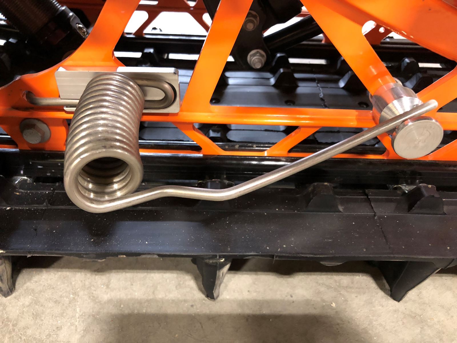

The best you can get is Ibexx !! A company out of southern Idaho! They work in reverse and are just great on my BTX.

Nice but no option for carbide tip. BRP has similar but this better being stainless steal.The best you can get is Ibexx !! A company out of southern Idaho! They work in reverse and are just great on my BTX.

Yep, my set that I got from you really work well once you take some time to get them turned just right so the spray is directed under the front of sled.
Put them on last season and so far flawless. I just used an eye bolt STOW for my Curve skis.
