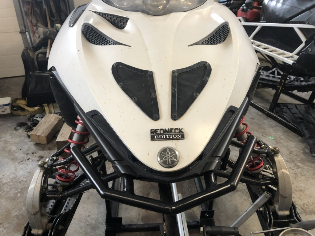

Got it installed and it looks sturdy. I think it goes well with the redneck emblem I put on.

Got it installed and it looks sturdy. I think it goes well with the redneck emblem I put on. View attachment 161927View attachment 161926

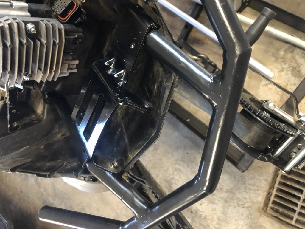

So I found out you have to have camera to the left.

Nice!!So I found out you have to have camera to the left. View attachment 161964

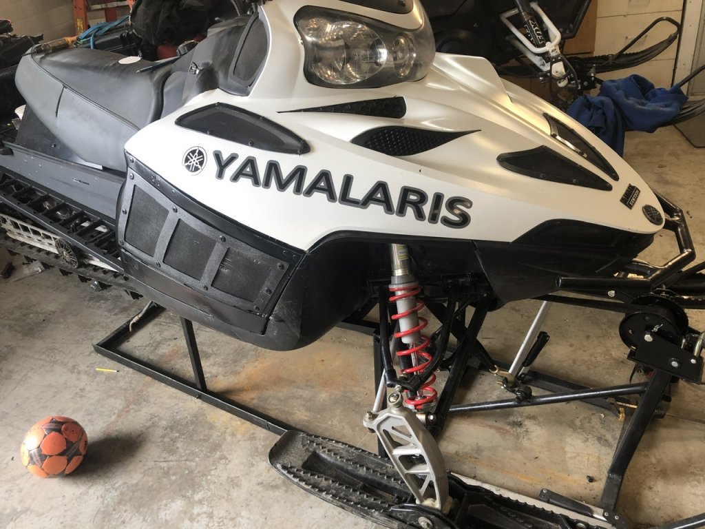

Well I got the stickers put on. It’s slowly getting done and ready for another season

Super cool build, nicely done
Nikolai
Nice build!
