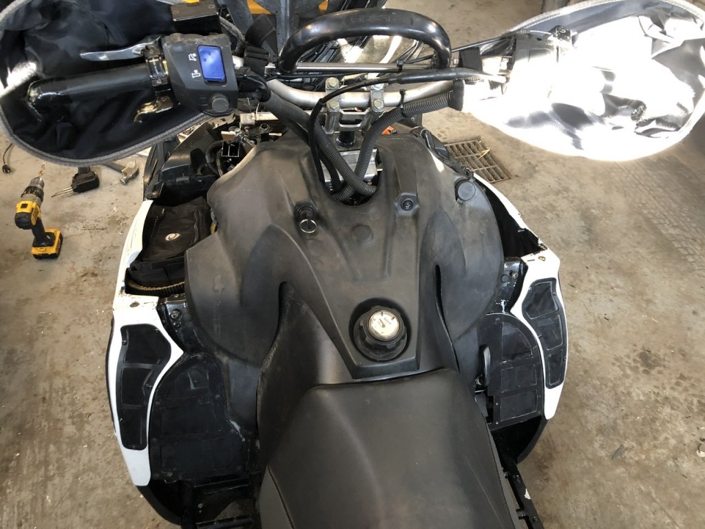

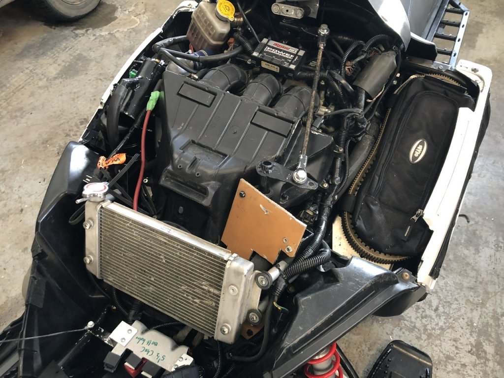

Getting really close to firing this thing up. I got all the rad hoses connected and radiator installed. I made a battery box and mounted it below the air box and I wrapped all the wiring to protect it from rubbing and such. Next is the wiring and fuel tank and filling all fluids. And then cross my fingers this baby will start.

Getting real now! I always dreamed of electronic steering on a sled, where the bars turn a switch and then an electric motor moves the skis, just be hard to ever trust that as fast as I ride and no way to formally engineer such a system, I don't need to die LOL. Good job so far! Be fun to get it running!

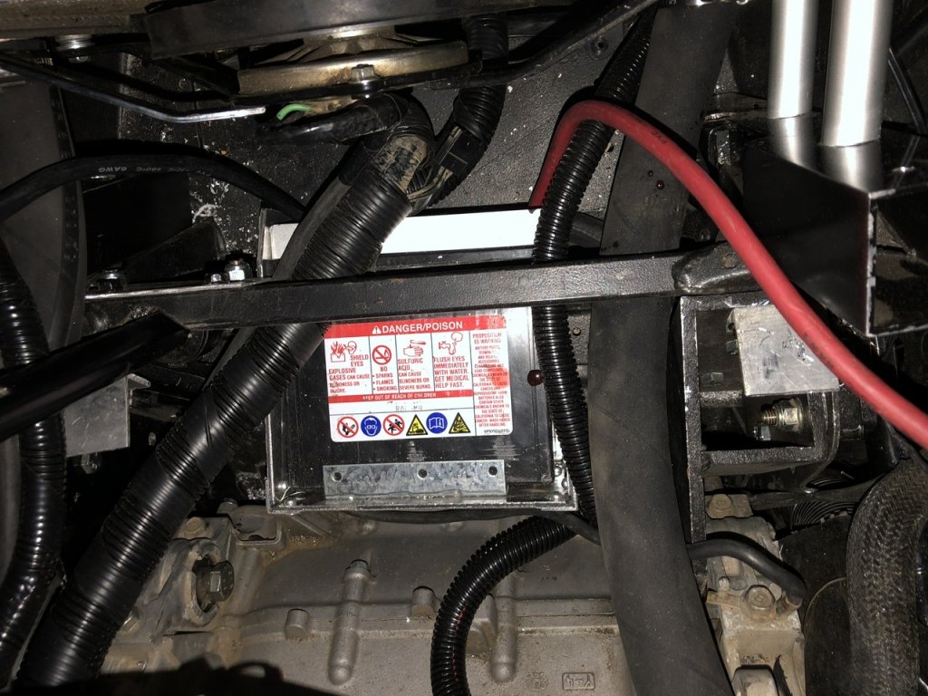

Well very little has gotten done on the build. I have been riding and fixing my turbo tank for the last few weekends
. I have got a battery box made and installed under the air box. And I also made a relay holder above the ecu.
