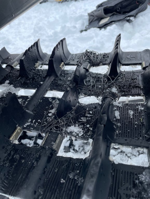

Well it’s been awhile since I updated this thread. I still do love this sled it is my go to sled. It’s had a hard life the last few years. Had to replace the track and rail Last year. This year the fuel line rotted out in the tank after the pump so got very little fuel pressure. Also had the main driveshaft bearing go on the chaincase side. And have been dealing with grip element wiring issues for some time. But last weekend I went on a 5 day trip and had no issues so maybe I’m done breaking things for this year.

Well it’s been awhile since I updated this thread. I still do love this sled it is my go to sled. It’s had a hard life the last few years. Had to replace the track and rail Last year. This year the fuel line rotted out in the tank after the pump so got very little fuel pressure. Also had the main driveshaft bearing go on the chaincase side. And have been dealing with grip element wiring issues for some time. But last weekend I went on a 5 day trip and had no issues so maybe I’m done breaking things for this year. View attachment 175711View attachment 175712View attachment 175713
