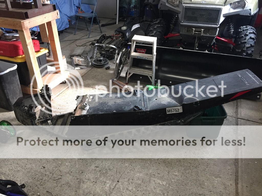

I ended up not having to buy any. A buddy had the front tunnel section and front frame member with the a-arm mounts he's letting me borrow to build the jig.

All you really need is the front bulkhead & front part of the tunnel since it has the suspension mounts. No need for the extension.

Whats the weight on that bad boy? Can you make a tubie front end lighter then that oem flat plate aluminum? I like the rectangle tube on the bottom of the engine.
Nikolai
It's heavy, I'll weight it after work.
Nikolai
41.5 lbs as pictured
Nikolai

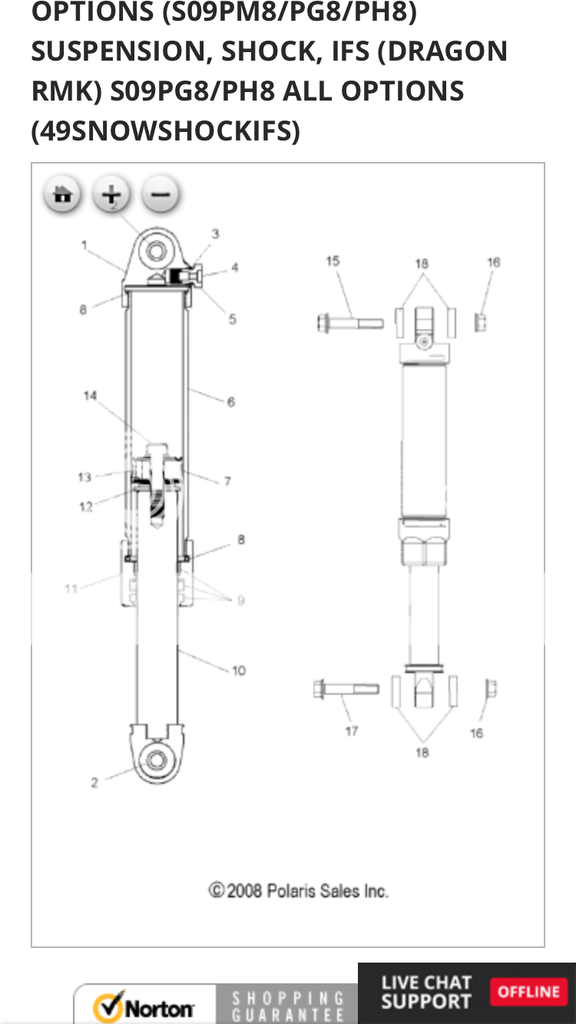

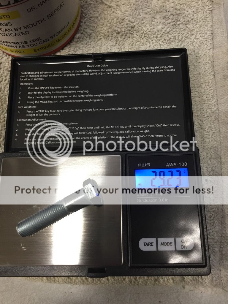

Out of curiosity I ordered fastener #14 from the WE air shock.
It's just a standard Grade 5 3/8 bolt. Easy to replace with Titanium.

Wow interesting. That is heavy. That front plate steel or aluminum? I bet you can save at least 20lbs replicating in 4130. The bolt in the shock, how much load does that see? Would a 7075 bolt work? How long can you get those WE shocks I think we need a 17" long shock. Lastly the tall spindles are heavy I am not seeing a lot of good options for them.
Nikolai
I'm not sure what kind of load is on that bolt. They are a little over 17" c to c iirc.
The tunnel has multiple spots where it's doubled up, it's not a light design, nor is it strong. My buddies shop had quite a few bent up tunnels.
