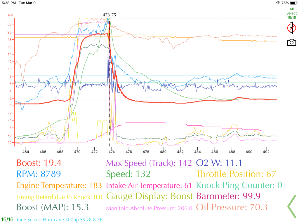

VERY NICE!Thanks to @HURRICANE this sled is a monster!

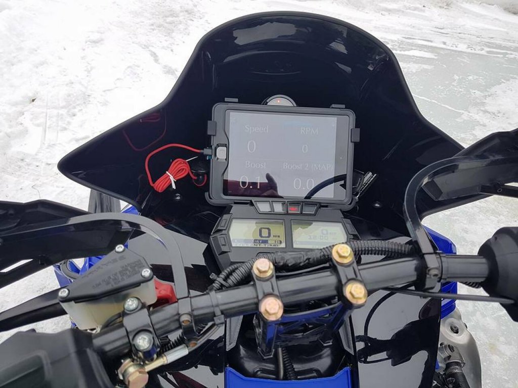

It's datalogging from Hurricane to an I-pad that I am still learning how to operate. But, it is my dash now and shows the engine functions. But the datalogging is priceless for tuning and recording runs. I just bought all of this recently and hooked it up 2-3 weeks ago.
My son taught me how to do a screen shot last night....LOL. Now I see a camera on the side where I could take a pic...LMAO!
This shows the max mph and trying to get the screen to stop on the exact point is hard. I was already off the throttle at this point. But shows the tune I was running also. If there was a knock, it kicks it down to the next tune which would be 270SS.
But I love this technology to record everything. The pic at the bottom is one I found on the internet showing how it is mounted.

MPH says 132?
The MPH reads that 132 cause I was already off of the throttle (notice the throttle position is not 100%). The 132MPH is in real time as the 142MPH was max.
Going through the file again, the speed and MAX track speed were the same at 142MPH, I just needed to "stretch" out the data lines further which makes it easier to read and pinpoint on.

Are u sure these speeds are correct.
Seems fast for the power level.
I know my 18 with the 141 read much higher than actual due to the different drivers with 3 inch pitch.
Try a Dragy out, or use the speedometer69 app.
I think you will find that your mph is off by over 10 mph at least
Yes, the speeds are within 2mph of my Garmin gps
