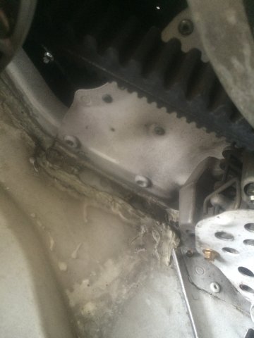

I suspect if we didn't have white tunnels, there wouldn't be much of a problem.
Seriously though, here's a thought; doesn't having the tunnel open to the exhaust allow some snow to filter into the engine bay? It's not a completely sealed area. The amount "flying around" in there would depend on snow conditions (powder, packed trail, ice) and could cause inconsistent amounts belt slip/wear. Maybe this has been discussed already??
stingray719
Discussed at length on the Cat forums. Some guys use sealer and seal up panels after putting sled together along with frogskin on every opening but I found that a lot of work and did not do it. I did however drill two holes in the belly on both sides where the water tends to pool so it can get out and not become ice.
