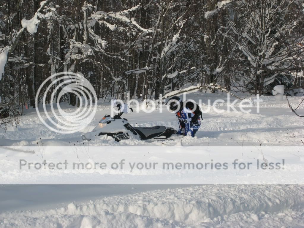

. And I don't really have any good pictures of them installed. Here is what I do have. The second picture is right after deep snow riding and just a quick sweep of my foot across the board.
The sled worked awesome. I forgot to put the revolver pins for the ZX-2 in my suspension, as I took one out over summer to buy another one from the hardware store and never put them back in, oops.
In deep snow, it was way better than last year. I could actually float on top the snow a bit and not trench everywhere I go.
The same could not be said for YamYboy's XRTX
With the sway bar off- I could easily tip the sled over off trail. Almost to easy. It was pretty nice. However the sled was worse on the trail due to the longer track and no swaybar. It was definitely a big bear to throw around on the trails. The clutching/rpms were really close, a little adjustment may be needed.
