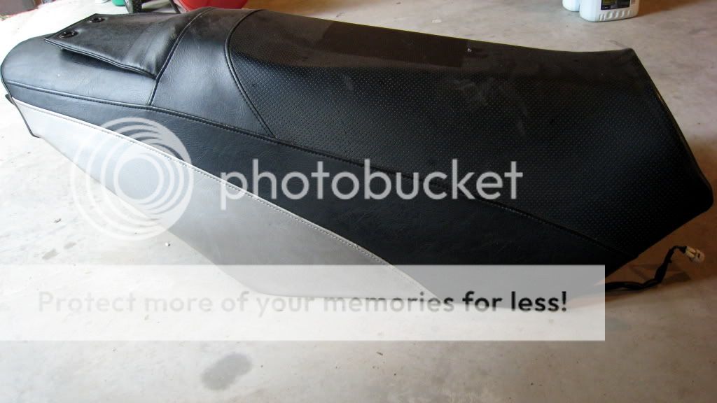

I then wanted to dye my grey stripe in my seat black.
So I bought some vinyl dye and prep online.

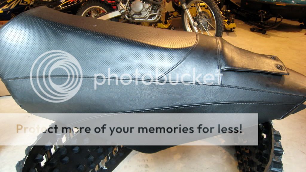

The seat turned out real nice.

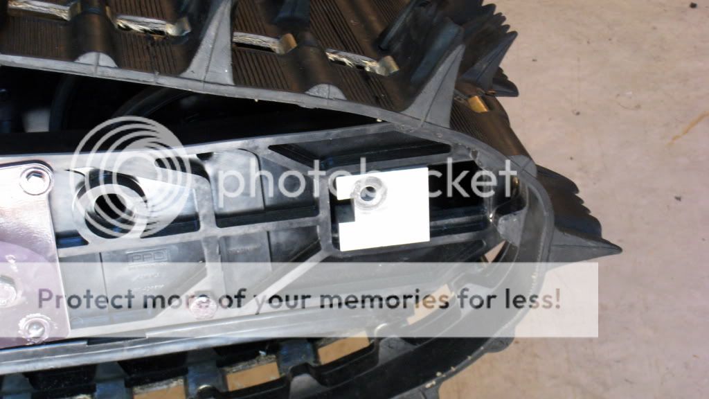

Now to my track problem.
I decided to through the rear suspension in a bit early since I had a bit of help around.
It went in really hard but after some time we got it in.
We had to take the rear axel out to get it in, and once we tried to get the axel back in we realized everything was a bit tight. I need another 1.5" of axel adjustabilty to get the axel to fit.
Here is a pic of the wheel with the adjusters up as far as they go.
Here is a pic without the wheel.
I thought I would try flipping that aluminum piece around so that the axel bolt hole would be to the front would give another inch or so of room.
I then tried to get the wheel on and if I really needed to and with a bit of help, I could get it on. But the adjustment bolts that stick out the back of the rails would still be very very close to the track. As in an 1/8 or 1/16" away from the track. And the track would then still be very tight.
I checked the track part# on the internet and found out the track was a 141" not a 144" like I thought it was when I bought it. I just emailed AD Boivin explaining the problem and the guy I bought the track from.
If I really wanted I think I could come up with a solution to make this track work. But I want it to be right, so I will see what AD Boivin says. But it looks like I will have to get a different track and take this thing all apart again.
