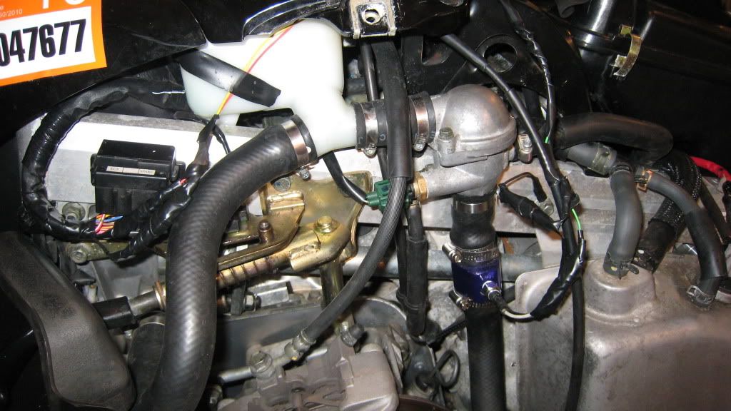

I started the sled up, after a while the temp gauge read 130 and the heat exchangers out back werent even warm. So I definitely have quite a bit more coolant to add.

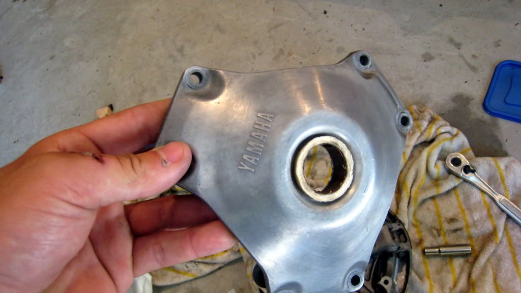

This primary cover bushing, was the biggest pain to replace, because it is like a fiberglass material and when pounding it back in, it started to flake a bit on the edge. I didnt get it in all the way, but I got it pretty close.

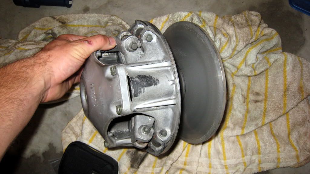

Replaced both secondary and primary clutch springs. On the primary spring the color of the grey was a bit off between the two, but I think they are the same spring.
Got both clutches back on, and quite a bit cleaner than they were before.

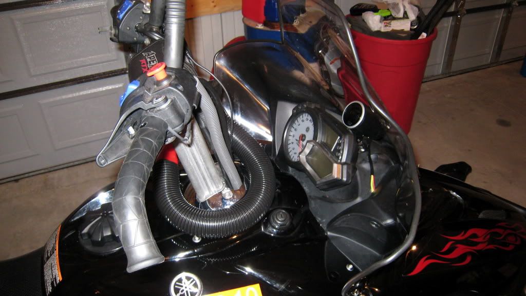

I wired my temp gauge in and spliced into a few wires near the fuse box.
Decided on mounting the gauge here.
Here is my crappy beginner wire job. I am not happy with how it came out. For now I will just electrical tape over all my quick connects for safety and protection. Maybe in the future I will go back and find some nicer quick connects and use those. Also the cold/heat solder gun is a piece of crap. It never got hot enough to melt the solder, so I had to come up with more inventive ways to solder wires without a gun.
At least all the wires are firmly together and the gauge works.
Here is shot of the gauge with the sled off and then on.

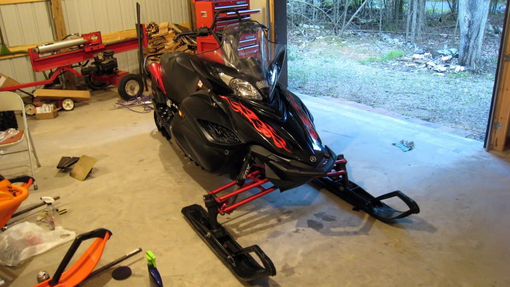

And then finally here are some shots of the sled pretty much all done and put together. Still have a few smaller things to do though.

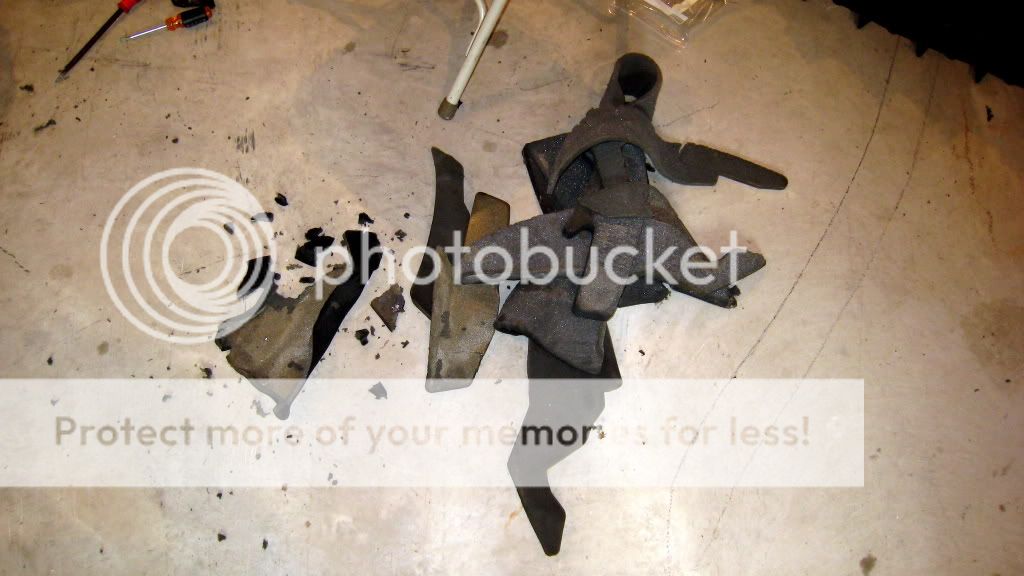

So I took all the foam out of my side panels with the idea that it will help keep things running a bit cooler. Noise may increase a bit, but well worth the trade off I think.
Here is inside of the side panel with no foam. What a pain it was to get this stuff off.

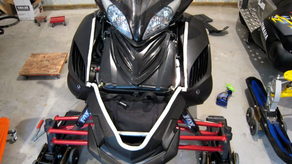

I then bought some foam tape from the hardware store and tried to seal up where all the panels attach to each other. I have read on this site and others that a few think most snow under the hood doesn't come from the vents put instead from a poor seal of the hood piece. The tape actually came out really nice and if it stays sticking on throughout winter it will definitely help keep snow out.
Here are some pics of putting the foam on, and then once with the hood piece on.

tkuss said:So I took all the foam out of my side panels with the idea that it will help keep things running a bit cooler. Noise may increase a bit, but well worth the trade off I think.
I've been thinking of doing the same. Let me know what you think of the increased "noise". If any. The sound of a 4-stroke is just nice ;-) And also if there is any added vibration in the body panels after you have removed the foam.
Thanks buddy!
