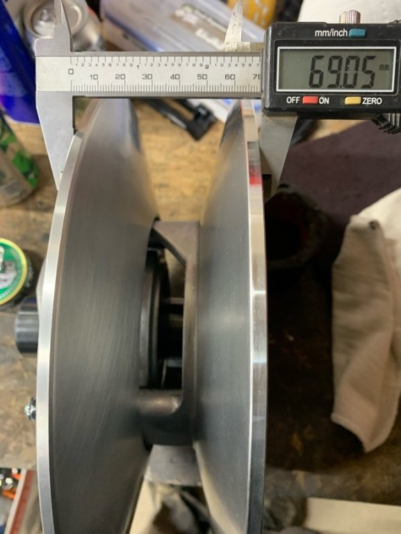

Nice work , so if i took 100 thou. Off my secondary, say 50 thou off helix and 50 thou of spring pocket in clutch would i see more top end? and would 90 degrees still be the same tension with it compressed 2mm less? would the b/o maybe run higher rpm and cooler at 90 degreesTo make sure I wasnt wrong I proved it to myself. The pictures here show a 2mm loss in travel and in real world actually a little more than that as I had to squeeze hard to get it here and in reality itll probably stop shifting before that. A good reminder of why winding tight coil springs results in guaranteed bind. If you never run at top end not a huge deal. Pic of open clutch measurement with no spring, pic of stacked coils and pic of measurement at max shift due to stacked coils.
View attachment 165914View attachment 165915View attachment 165916

You lose tension if you machine pockets, kinda like shimming the helix. You gain some travel before bind but sometimes end up needing to wrap tension higher to get the same pressure you had before which wrapping extra makes you closer to binding again. Much better off to use a dalton spring or even the tporange as these springs can go theough the whole shift cycle without beingclose to binding. If you use BO spring you may have to try a few different wraps to see what you like best but like knapp mentioned above, 6-2 is usually good for stock up to 240hp and larger tunes 270+ seem to like 6-3Nice work , so if i took 100 thou. Off my secondary, say 50 thou off helix and 50 thou of spring pocket in clutch would i see more top end? and would 90 degrees still be the same tension with it compressed 2mm less? would the b/o maybe run higher rpm and cooler at 90 degrees
