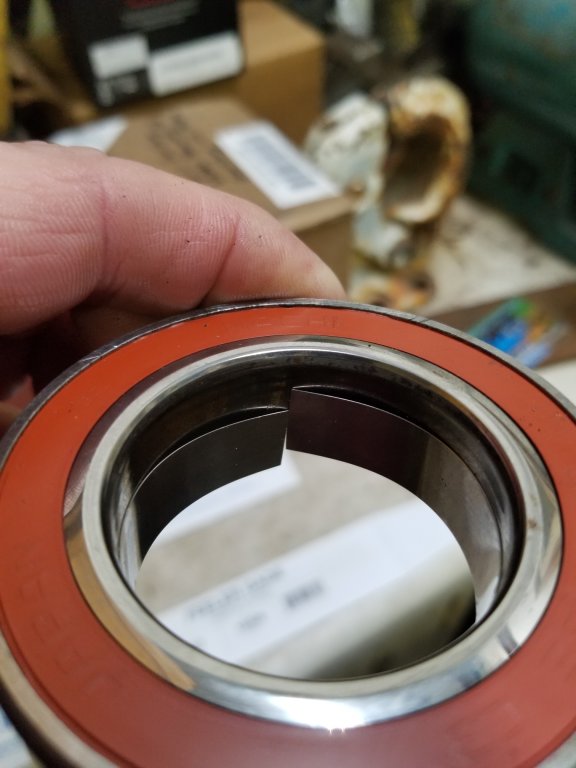

Well since the new axles are on back order and I didn't have time to remove, weld, and turn my axle in between trips. I came up with a fix. I had some shim stock available at industrial supply store. I measured the new bearing and worn shaft. There was .018 difference I cut the .008 shim stock to fit in the bearing put it back together and used the BOP wedge. 1200 miles later it still looks good.
