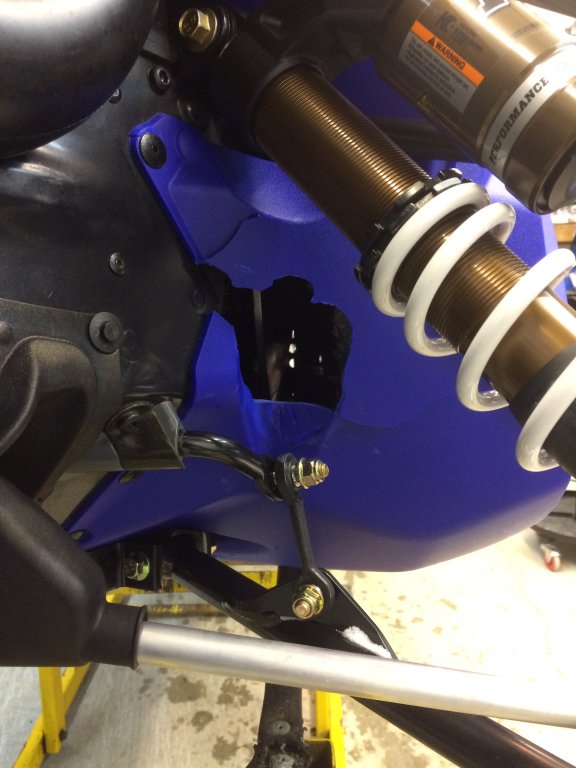

Just came back from Munising TY ride and beat the snot out of my sled until I blew a belt.

Where do we go from here? I am machined for coil-bind and beat the ever living snot out of my winder this weekend. Did more cat-walks than can be imagined and just was not nice to that belt. When the belt blew....it was just crazy hot in temperature....but the clutches were warm to the point where I could hold my hands on them for any length of time.

Oh my, that's a big hole. What does that plastic piece cost?
