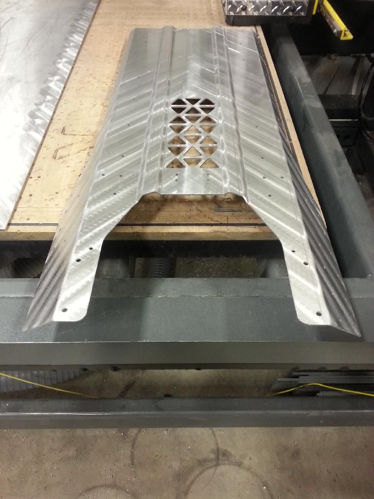

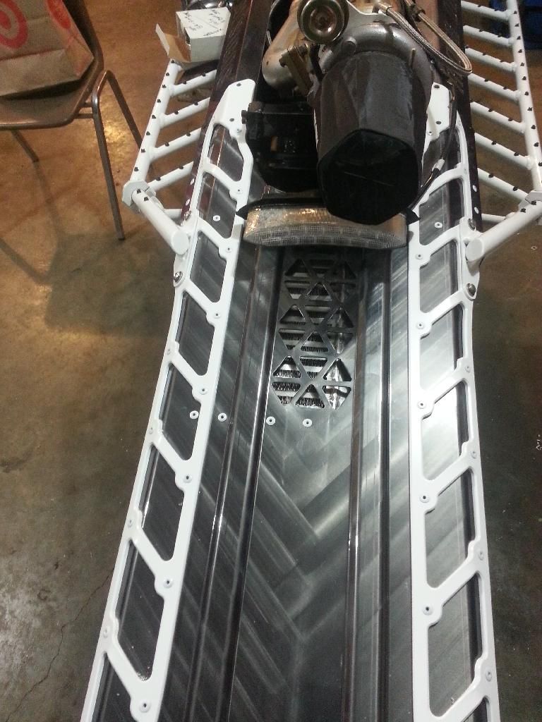

There wasn't damage to anything structural so instead of redoing the entire tunnel, I decided just to design an extension for it. Added some ribs down the center to make it stiffer.
Cut square and ready for the extension.

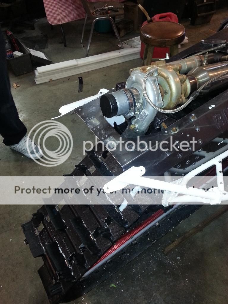

At this point I also clocked the turbo because I'm now adding a rear mount intercooler.
Intercooler mock up
